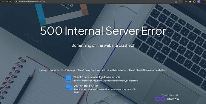

Cannot see errors in Codeigniter project
http://ieee-restapi.great-site.net
I am trying to create a basic codeigniter API, as of now it has nothing fancy, the home page is codeigniter home page that it gives by default when you create a new one, which should be visible to once you hit the link but it gives 500 internal server error instead. I have tried 2 ways, putting all the folders in htdocs and even the items in public folder outside in the htdocs. Next I even tried putting the project as it is in a single folder under htdocs.
I have errors enabled and even after doing alter php config, .htaccess and inside production and development.php in the project..
I feel like giving up on hosting this and just use laravel or something, any help is appreciated.
Hi and welcome to the forum! This error is generated by the server itself, not your browser, so you need to check your .htaccess file for any errors and, if any, correct them.

Being redirected to our 500 error page usually means that the .htaccess file contains invalid rules. Looking at the code you shared, I don’t see anything obviously wrong in it. But you may want to try commenting out some of the rules and see if that helps.
