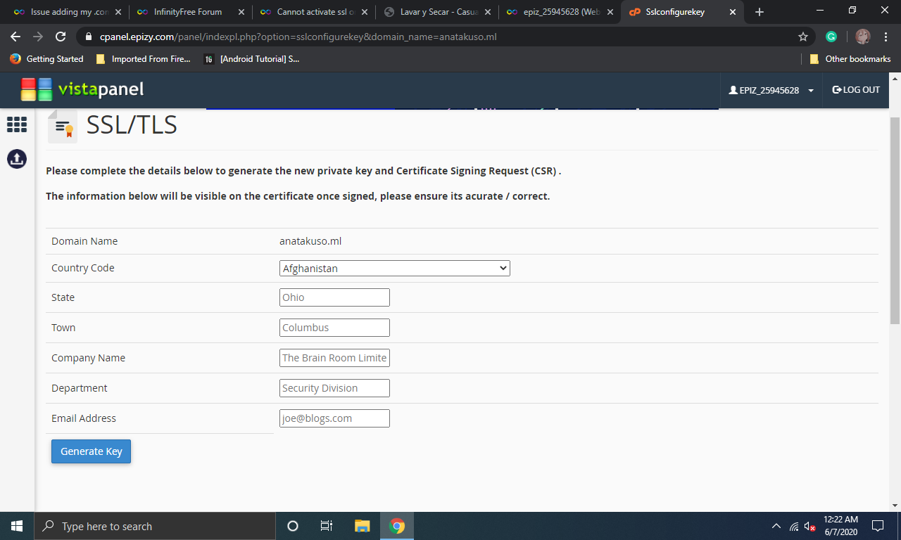

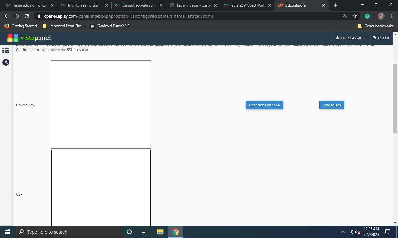

First of all,
Where did you get your SSL? You can get free SSL and automatic install when you go and setup here.
Control Panel > SSL/TTS > Configure > Generate key/CSR
It will automatically install once you have done completely the form, and you just need to wait about 30 minutes or an hour.
And it will add the certificate key here automatically

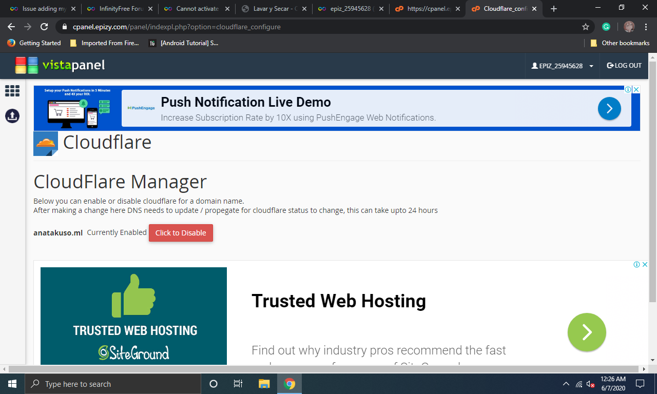

Using Cloudfare
By going to Control Panel > Cloudfare > Alter Cloudfare > Enable
Enable it and wait for about 30 minutes or an hour or a day.

Just some things to note about your instructions:
  • You only need to use the Generate Key/CSR function if you want us to generate a CSR so you can get an SSL certificate from a third party provider by giving them the CSR (and not giving them or having them generate the private key for you).
  • You don’t need to generate a key/CSR if you’re not going to upload an SSL certificate.
  • You don’t need to generate a key/CSR if you’re going to let another tool generate a private key for you (like our SSL Certificates tool does).
  • You don’t need to generate a key/CSR if you’re going to use Cloudflare. Cloudflare can work without any SSL setup on your hosting account.
Just something for future reference for you or anyone else reading this topic.
But this explanation does create some perspective about why you say you don’t like our SSL Certificates tool: you’re doing many complicated and unnecessary steps.
