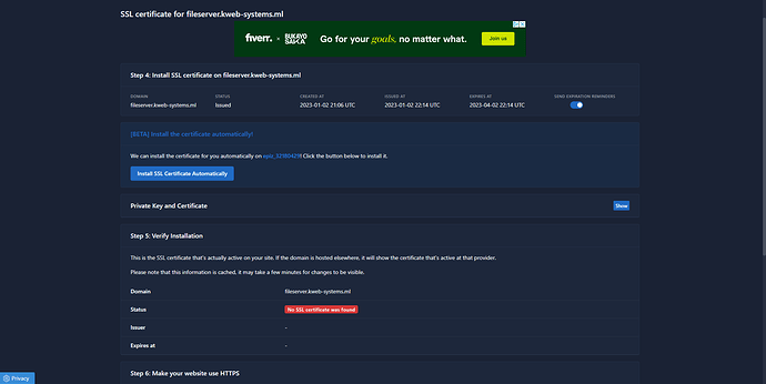

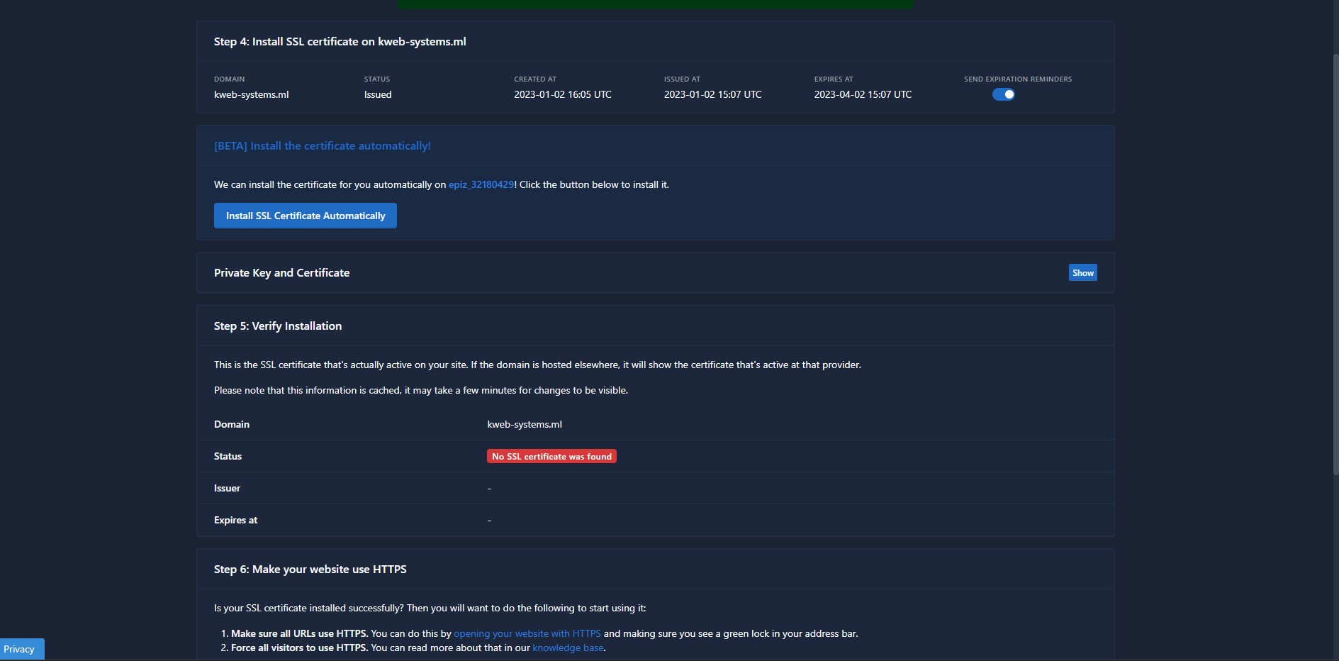

Can Request and even Get SSL Certificates but cannot install them
fileserver.kweb-systems.ml and ki-young.ml

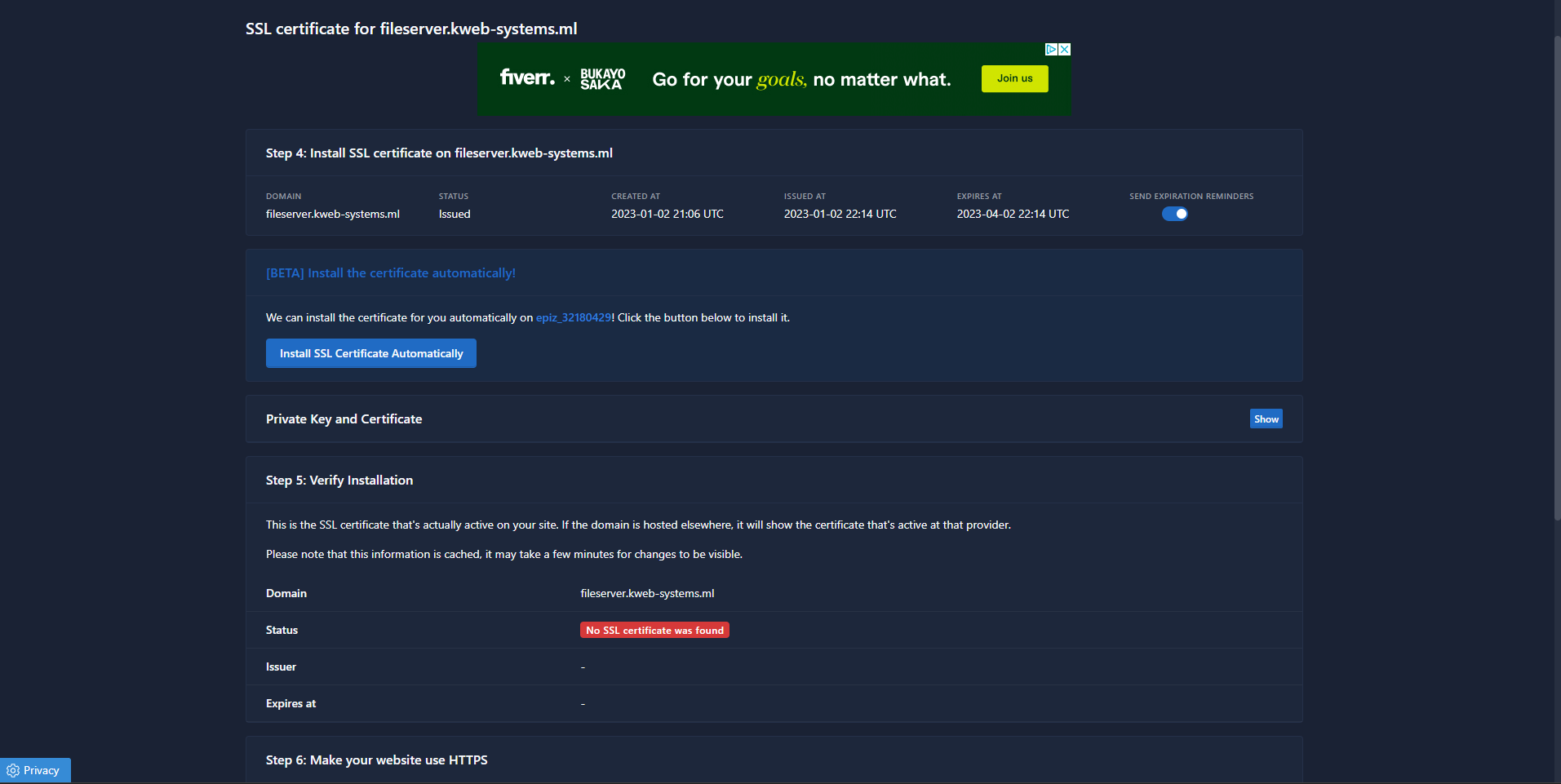

Cannot connect to it via HTTPS but both certifcate and private key are uploaded and issued
Happening on all websites on my account
kai-young.ml not ji-young.nl
I see mixed nameservers
Resolve this first
I added the cloudflare nameservers hours after the issue started.The cloudflare nameservers are an attempt at securing an ssl certficate through them. I am glad you see nameservers tho because i have spent hours trying to
epiz_32180429 or Website URL
Affecting Sites
kweb-systems.ml
Kai-Young.ml
Can Generate SSL Certificates change cname records and click upload on both private and Certificate on records but the SSL certificate doesn’t install.I have tried both manually and automatically changing them. As well as different Certificate authotirities such as “zerossl” but to no luck.

NEVER use multiple sets of nameservers at the same time.
Cloudflare can do HTTPS for your website, but they don’t give you a certificate you can use here. You can remove our nameservers and let Cloudflare do HTTPS, or your can setup SSL directly with us.
The issue here was that your certificate was installed but wasn’t being picked up by the server. That issue has been fixed now, so SSL is now working.
