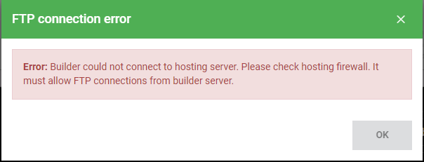

Builder could not connect to hosting server
https://wyzgrow.com
Infinity FREE Builder: Builder could not connect to hosting server
File Zilla:
Status: Resolving address of ftpupload.net
Status: Connecting to [64:ff9b::b91b:860b]:21…
Status: Connection established, waiting for welcome message…
Status: Initializing TLS…
Status: TLS connection established.
Status: Logged in
Status: Retrieving directory listing…
Status: Directory listing of “/” successful
Response: 421 Timeout - try typing a little faster next time
Error: GnuTLS error -110 in gnutls_record_recv: The TLS connection was non-properly terminated.
Status: Server did not properly shut down TLS connection
Error: Could not read from socket: ECONNABORTED - Connection aborted
Error: Disconnected from server
I really am stuck with this problem for so much time now. I have studied thousands of FAQ’s for this problem. Watched at least a 100 videos, surfed on the web for so much time but couldn’t find an answer.
  • don’t even know that what to upload in the ftp server of filezilla from my local device. Like what should I upload from left to right.
Someone, Help Me Please.
Like I am so much stuck on this problem.
This looks normal. It seems you are able to successfully connect to FTP, and then the connection is interrupted. But that’s normal, and caused by the inactivity timer.
I also just tried to publish your website from Site.pro and it just worked. Maybe it was caused by rate limiting on our firewall temporarily blocking Site.pro. But whatever it is, it seems to have subsided.
