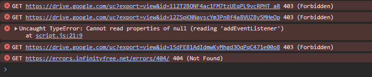

Screenshot 2024-01-13 114524
I see this

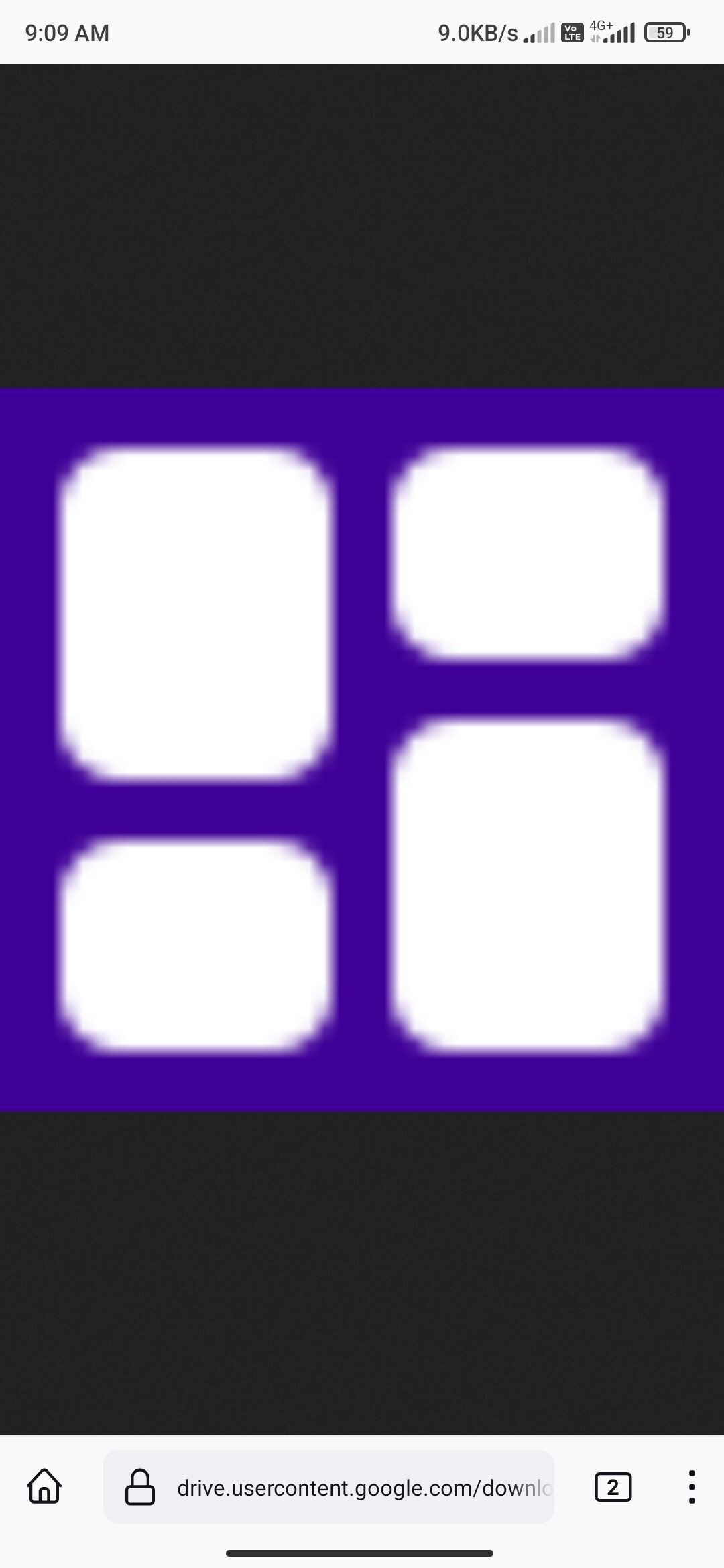

Clicking on 403 link shows this
These may help
Fooling around with embedding Google Drive links myself, I found that it doesn’t work if you use the sharing link (i.e, this method doesn’t work) to embed the images on your site (Google doesn’t seem to like you using that method in that way).
However, getting the lh3 url of the image seems to work fine.
