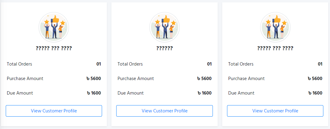

I am trying to show Bengali text (more specifically, username) to the user, which is coming from the Database. But I am getting multiple question marks in the view (front-end) (???) instead of the username. I have attached an image here so that you can understand it nicely.
How can I solve this problem?
I will be very grateful if you kindly help me with the solution.
Thank you.
Screenshot of the problem

I checked the source code of the web page and I can guarantee that inserting html attributes regarding language won’t fix your problem.
I see you are using html files, how do you fetch from the database using it?
I checked your code and I think the issue is database and encoding related. The PHP code spits out the question marks, so that’s why you see question marks on the page.
This is caused by one (admittedly not very smart) design flaw in how our database connections work.
By default, our PHP installation uses the latin1 charset for MySQL character encoding, but phpMyAdmin always uses utf8. This means that if you insert special characters with PHP, it will show up as gibberish in phpMyAdmin. And if you enter special characters with phpMyAdmin, it will show as gibberish in PHP.
The text in your database looks fine when looked at from phpMyAdmin, and your code doesn’t specify a character set, so I think the database query in PHP returns gibberish. And you’re feeding that to htmlspecialchars, which has no idea on how to encode the gibberish and just prints question marks.
The fix is quite simple: in your database connection snippet, use the mysqli_set_charset function to set the connection charset to utf8 or utf8mb4 (doesn’t really matter which). This should make the text appear correctly on your page.

Thank you for your reply. I have added the mysqli_set_charset function in my database connection snippet, and it worked.
