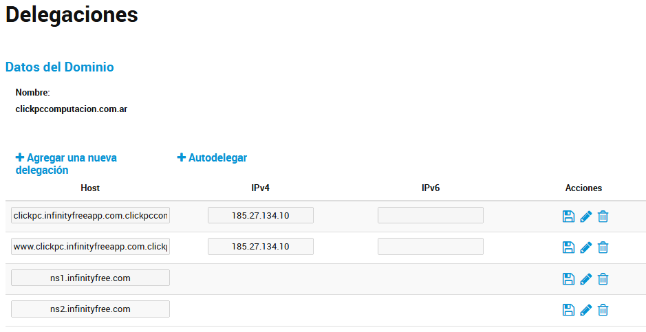

Comparto Resultado de https://nic.ar/tu-dns/info
Encontramos 3 posibles mejoras
Categoría Dominio Resultado
spf clickpccomputacion.com.ar No se encontró el registro SPF para el dominio
dmarc clickpccomputacion.com.ar No se encontró el registro DMARC para el dominio
http clickpccomputacion.com.ar El servidor web da un error en la página del dominio.
mi dominio en infinityfree funciona correctamente, ( miwebclickpc.infinityfreeapp )… pero cuando quiero que apunte a mi dominio pago de Nic.Ar no logra conectarse y necesito una solucion.

As for the DNS problems you’re seeing, I see a few issues:
  • Your domain has ns1.infintiyfree.com and ns2.infinityfree.com in it’s nameservers, but the domain is not actually assigned to any hosting account. That means that there are no DNS records for your domain in our nameservers, and there is no way to configure them. You’ll need to add your domain to an account to host it with us, even if you don’t want to use our nameservers.
  • In addition to our nameservers, your domain also contains the nameservers clickpc.infinityfreeapp.com.clickpccomputacion.com.ar. and www.clickpc.infinityfreeapp.com.clickpccomputacion.com.ar.. These are invalid and should be removed.
Once your domain name is correctly pointing to our nameservers and setup to your account, the http category should be addressed automatically. Once the domain is setup, you can also setup an SPF records for your domain through our panel.
The only thing we do not support is DMARC. DMARC is mostly irrelevant if you’re not doing email, and not even required unless you send a lot of it. But if you do need it, you can host your DNS externally instead.
