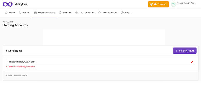

My hosting account is active and the domain ambedkarlibrary.wuaze.com is listed in my hosting account.
Hosting IP shown in dashboard: 185.27.134.101
DNS lookup using Google DNS (8.8.8.8) returns: 185.27.134.24
The website sometimes displays the library homepage, but at other times it shows the DNS Resolution Error page. I have uploaded my website files to the htdocs directory.
Please check the DNS configuration and domain-to-hosting account mapping.
Thank you.

The domain on your hosting account (the one with website IP 185.27.134.101) is spelled slightly differently from the one in your post. One letter in the word “library” is different. Can you open the account in the members area and check exactly how the subdomain is spelled there? If it isn’t the same as the address you’re visiting, that would explain why the “domain isn’t connected to an active hosting account” page shows up.

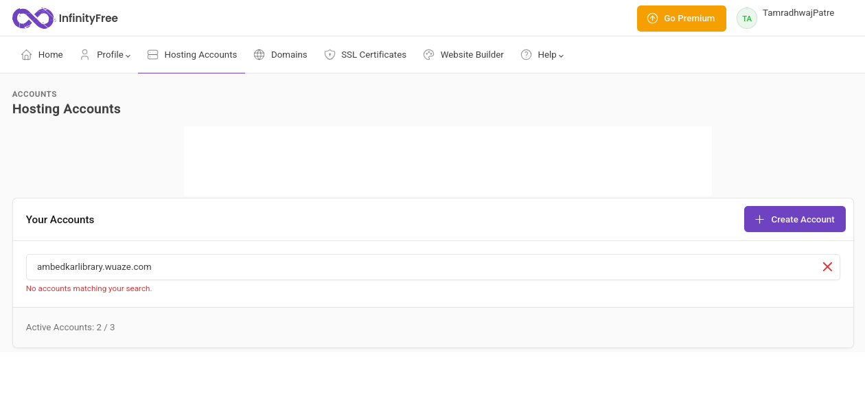

I checked it… and it isn’t.
The actual domain on your account is ambedkarlibrery.wuaze.com. Quite clearly a typo (librEry instead of librAry). But it does mean the domain ambedkarlibrary.wuaze.com doesn’t work because it doesn’t exist.
You can either create a new account with the right domain and deactivate the old one, or just add it to the existing account.
