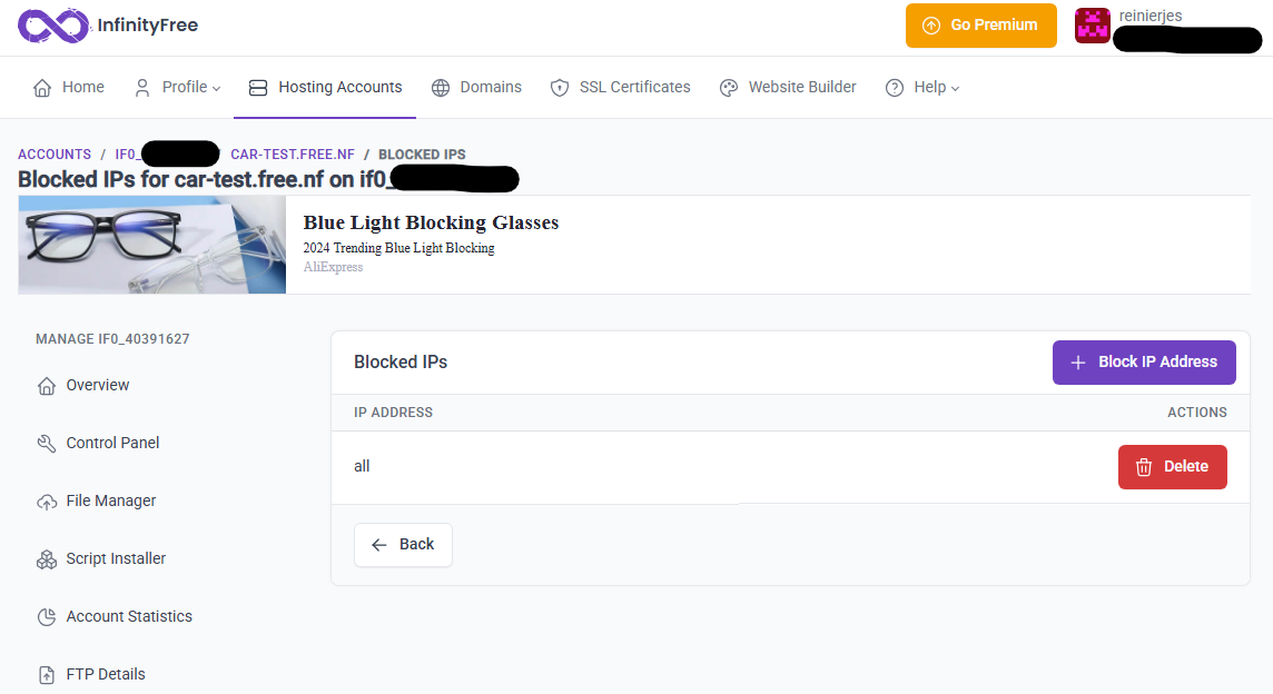

I’ve been building an academic car rental website with laravel (https://car-test.free.nf) but at some point I could no longer access it from any other device or location, there’s always a timeout error. In the account management interface I checked the IP blocking section out of curiosity, and there’s a rule I can’t delete that is blocking all IPs trying to access the website. However, the website is accessible from the devices I originally used for development and testing before the rule appeared; all others can’t access it due to a timeout error.

this is how the blocked ip addresses section currently look and it doesn’t matter how many times i click delete it doesn’t get deleted

If it were to block “all“ connections it’d need to be *.

OK, so the blocked IP listed there is not actually the case, but rather the client area misreading your .htaccess file. Specifically, it finds the “To prevent access to .env and other files” .htaccess rule.
It’s a bug in the client area, but it’s not the cause of your issues. You can safely ignore that entry.
