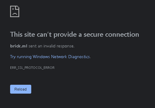

I had restored FTP backup on my new domain brick.ml but, its not working
did you upload sql backup? Updated wp-config.php database credentials?
This is what I see
Make sure you have valid SSL cert
I am using a Self Signed Certificate which is compatible with cloudflare and has a validity of 10 years

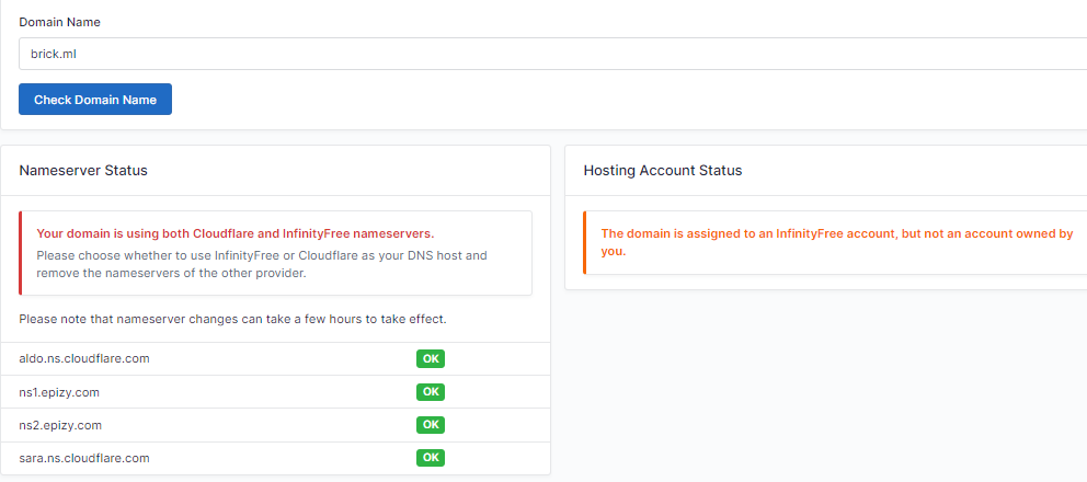

When I checked your domain, it was only using our nameservers, not those from Cloudflare. If that’s the case, you can configure whatever you want on Cloudflare’s side, but it will not have any effect on your domain name, because no traffic is routed there.
If you want to use Cloudflare on your domain, you need to remove our nameservers and add those provided by Cloudflare.

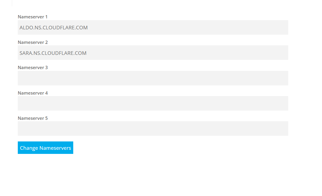

I had removed infinityfree nameservers 24 hours ago but still my domain is not working
Now, I don’t see any nameservers on your domain.
If you use our Domain Checker, you’ll see it’s using ns1.epizy.com and ns2.epizy.com. You can confirm it with a third party nameserver checker if you want. I just checked it by and and it’s correct.
If Freenom’s settings show something else, that’s an issue with Freenom. We cannot help you with that.
