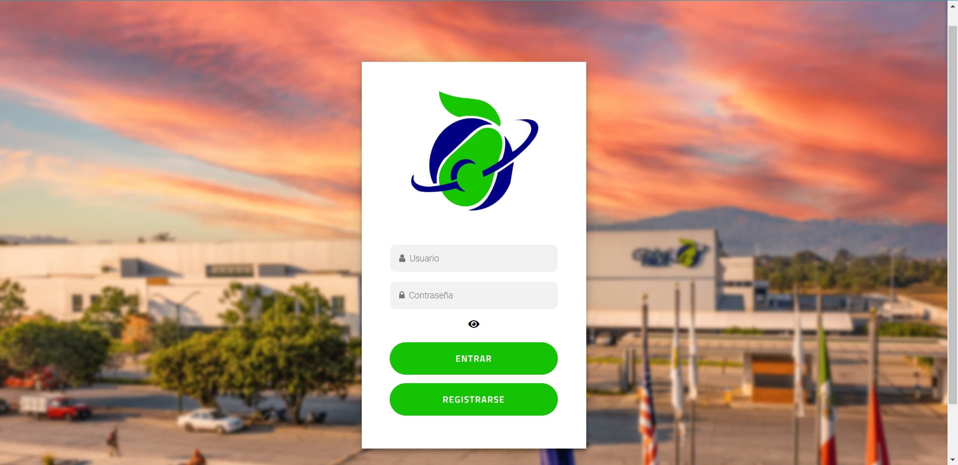

If that isnât the issue youâre facing, can you please explain what youâre trying to do and what error youâre facing? Your main page works fine for me:

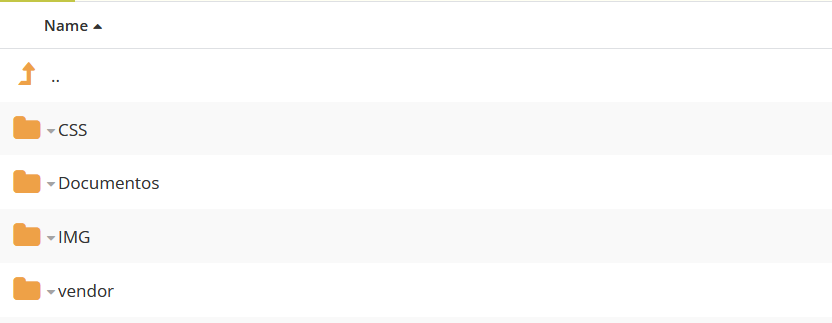

but i have a index.html
In the vendor folder? Going to http://gfpagoproveedores2.rf.gd/vendor/index.html redirects me to a 404.
The index.html in your htdocs works fine, as your website displays correctly for me.
vendor folder, is a folder that contains libraries to send email by my web pageâŚ
but in the window where proccess that, dont wokrs fine because dont accees to the folder, but i checked everything and everyting looks good as we have in my pc like local page (there works fine)
require âvendor/autoload.phpâ; this the part of the code where no access
Did you also upload the vendor folder? You canât run Composer on our servers to install the dependencies here, so you will need to install them on your own computer and upload the generated vendor folder here.
yes, i already upload the vendor folder

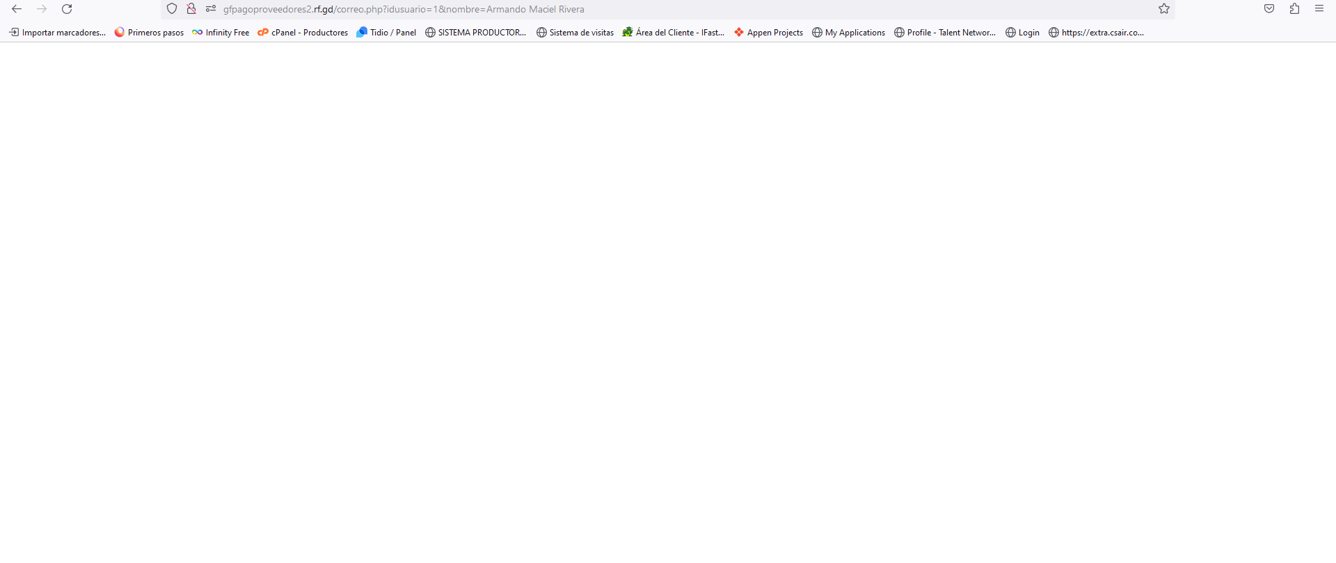

Doesn´t exist a error, when i compiled my code just works the first part but when arrive to the part ârequire vendorâ dont do anything, not appear a error or something like that.
its like the server dont permit the access to the folder because when i compiled in my PC as a local with xampp works everything
So what do you see? You see you donât see an error, so what do you see instead?
Do you see a blank page? If so, you may need to enable display_errors first: Http error 500
If you see something else, what do you see?
And again:
If you want to speculate about permissions or whatnot, go right ahead. But please give us the information youâre basing that on too, or we have no idea whether that speculation is accurate at all.
YES I SEE just blank pageâŚ
but the first part works well because before to accees to the folder i made a register in my BD and that do without problem.
but when pass to the part to access that folder appear a blank page
Did you do this?
now appear this errro
Fatal error: Uncaught Error: Class âComposerAutoloaderInit5a360facea79a6ba3440ba7eaed9051aâ not found in /home/vol6_3/infinityfree.com/if0_34834454/htdocs/vendor/autoload.php:6 Stack trace: #0 /home/vol6_3/infinityfree.com/if0_34834454/htdocs/correo.php(6): require() #1 {main} thrown in /home/vol6_3/infinityfree.com/if0_34834454/htdocs/vendor/autoload.php on line 6
