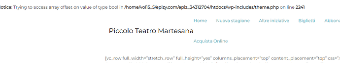

I see this instead
which doing this may fix the issue
I reinstalled wordpress as per your suggestion, but nothing changed. I wonder how you see the notice message instead
If you go to Control Panel and “Alter PHP Config” – select your domain and click ‘Alter PHP Directives’ – do you have “Display Errors” set to “ON”?

I did some research on some of the shortcodes that seem to appear on your site, and one post in WordPress’ support forum mentioned the WPBakery Page Builder plugin, were you using that? If so, the site may require it to function:
