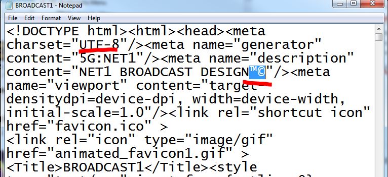

what are “special characters” ?
do you mean this kind of style ?
if the editor recognizes UTF-8 CODE, then why would it be a problem to scan ?
Iv Capped the site to 25 pages, and its now ok
but still far to slow to load.
I checked the file in my editor and this is how it prints for me:
In the web page, it renders like NET1 BROADCAST DESIGN��.
So I kinda doubt that the TM and C sign there are UTF-8.
Also, setting the HTML charset to UTF-8 doesn’t automatically means the characters in the file are UTF-8. And Windows Notepad has the tendency to use weird Windows character sets.

I dont know what editor your using to view the htm code
but ALL big companys will use | ™© | © | ® | etc
they dont have a problem with it.
