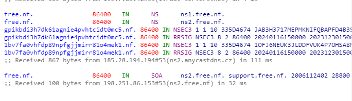

But free.nf’s NS contains byet NS’ too. Client area is being weird for some reason.
Something is wrong
It’s different on my side :thinking:
I always look at the top nameservers when I check them, as for me what matters is the nameservers set domain-side, not the NS records returned by the nameservers set domain-side. So don’t look at the bottom side; they’re only two nameservers in reality, and when I checked now they’re five.
Or just tick “only first nameserver” and use NIC as nameserver :slight_smile:
That on dig from the terminal requires me to find the NIC main DNS server, then query that server; but I don’t have time for that.
I figured it out, replace the domain and the TLD accordingly
dig ns lauraorchid.link @$(dig ns link. +short | tail -n 1)
That’ll return 2 he.net nameservers, while just dig ns lauraorchid.link returns all 5 :smiley: And yes it looks weird :exploding_head:
Also here’s my gist for not so weird version ^^
NS checker from TLD's NIC server. · GitHub

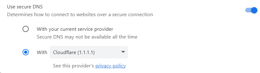

Quad9 seems to have blacklisted free.nf and all subdomains under it; except for their 9.9.9.10
(Unsecured: No Malware blocking, no DNSSEC validation) option, the other two 9.9.9.9 (the most common one) and 9.9.9.11 return no records when free.nf or any of its subdomains are queried.
wuaze.com and kesug.com seem to have the same treatment; all other IF subdomains I tested work fine.
I was planning to switch to 9.9.9.10 anyway, was getting tired of having to switch to Cloudflare’s DNS in such cases, just thought I’d mention it. I’m curious how their appeal process is; checking https://quad9.net/result I saw that all three domains are blocked because they’re listed on the IBM XForce Exchange list, so I’m guessing an appeal would need to be made to them as well.
What’s wrong with cloudflare DNS? I’m using it on my phone and have zero problems :man_shrugging:
I’m not saying there’s something wrong with them; I meant that I wanted to use Quad9, but found myself constantly having to use the “Use secure DNS” option with Cloudflare in Chromium:
Every time I’d hit a website for which Quad9 would return nothing, thinking it was their DNS cache when in reality they had just blacklisted the domain. I was going to either have to find a different DNS resolver or see if I can make Quad9 work, and thankfully their “no scanning” option works great and aligns better with my overall philosophy (I didn’t want my resolver to make the decisions on what site I couldn’t visit, such blacklists were the reason I switched from my ISPs’ default one).
