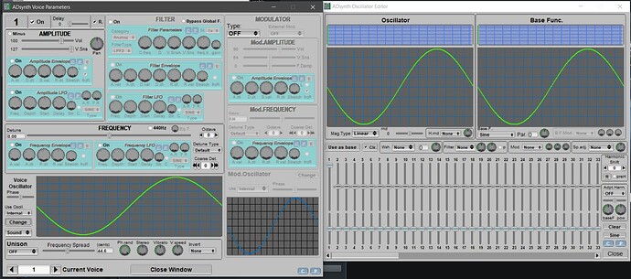

Also, I found a new toy :slight_smile:
It’s free!
Compare to this, which is also free (and what I have been using up until now):
(2 windows out of however many there are I can’t count them all lol)
Much cleaner interface!
But the real question is, does it work better, is it faster?
It is going to take some time to learn, but overall, I think it works better with LMMS (and while there are differences and limitations, it’s just like learning a different programming language. There are different ways you have to get around the “barriers” to achieve the same or similar result).

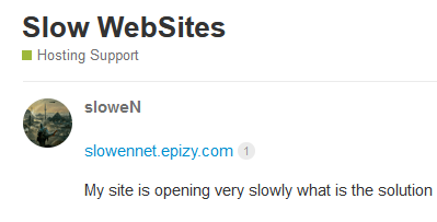

That’s because your address starts with “slow”
you need to rename it to “fast” ?? :joy:
I wanted to say “well at least it fits the name” :joy:

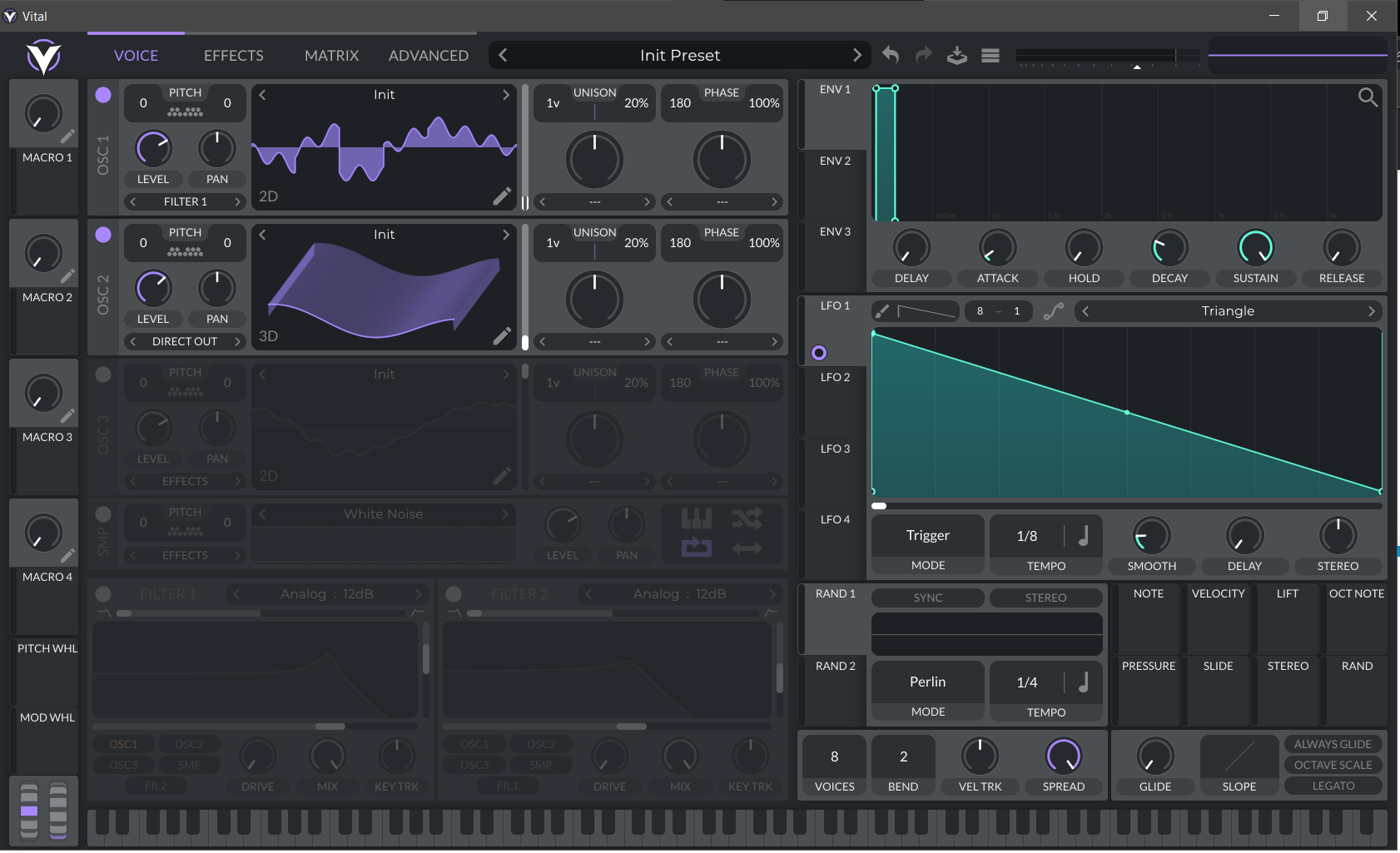

There are only two things not made with vital here (nor were made by me), the higher pitched metallic sounds before the drop, and the low kick. The rest were made solely by me (one I followed a tutorial on and then tweaked and tweaked further by making it into a slightly different sounding instrument). Hey, progress! I might perfect things later.
@Oxy, how did I do?
I didn’t sidechain yet as I didn’t know whether or not I want the kicks to stand out (maybe I’ll try it and see the difference)
