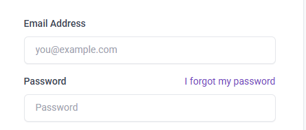

I can’t log in to the cpanel now. It won’t accept my password. I thing I’ll end up going with the other hosting site I found. It can’t be this problematic. If it takes forever to just get started - there’s no point.
Can’t log in now. Even though I took a picture and wrote down my password.
Really sorry to hear you’re having problems. thats not the norm, I assure you.
If you’re having problems logging in, your best bet is probably to do a password reset through the “I forgot my password” button
I understand that you’re saying you didn’t forget, but maybe a typo or something caused the wrong password when you signed up. Things happen.
Once you’re logged back in, As Greenreader9 said, try running the wordpress installer again. If you’re still having problems let us know and we can try to help :slight_smile:

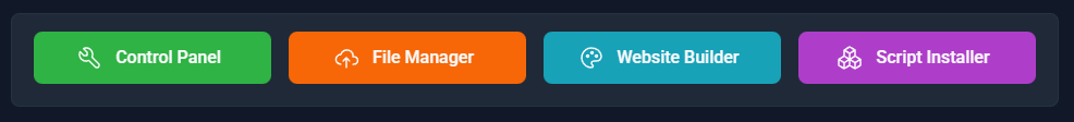

Which Cpanel are you on about? because if you’re logged into your dash board, and go to the control panel there then it should log you in automatically:
Same for the script installer.
(If either of these don’t log you in, then close the tab, refresh your dashboard and then reload them, sometimes the login stuff times out and needs refreshing)

Please be aware that hosting a WordPress website with us means you’ll need to interact with a number of different systems, which each have their own credentials, including:
  • Client Area. This is where you manage all your hosting accounts, and you can login with your email address and password, or one of the different social login options.
  • Control Panel. This is where you can manage the settings of an individual hosting account. You can login with your hosting account username (which looks like if0_12345678) and your hosting account password, or you can login using the buttons in the client area.
  • Softaculous. Where you can install scripts to your website and manage software that’s already installed. You cannot login to this one directly, you must use the buttons in the client area or control panel. If you see a cPanel branded login page, just close the tab and go back to the client area or control panel to login again.
  • WordPress. Where you can manage your own website. You can login with the username or email address and the password that you chose while installing your website, typically by adding /wp-admin after your website URL. You can also use the admin login button from Softaculous, but given that you have to go through both Softaculous and the client area first, I suggest just logging in to your website directly.
While our integration with Softaculous is admittedly a bit janky, this distinction of client portal, hosting account and website administration is how most hosting providers work.
