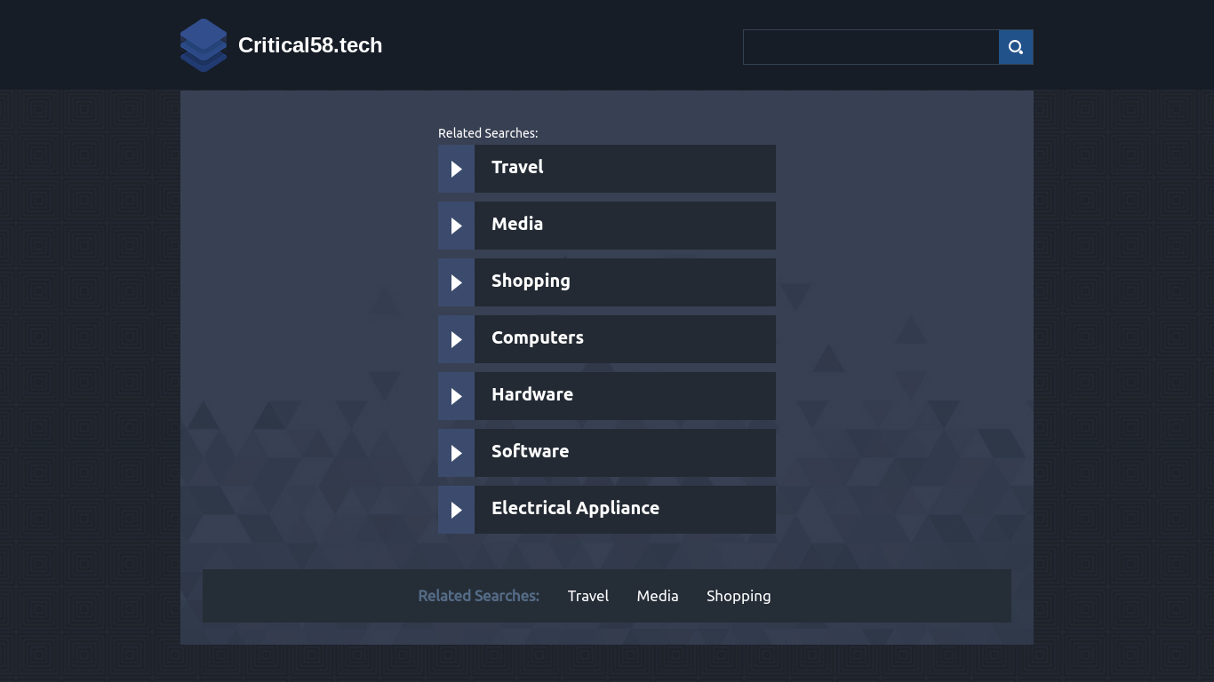

The website seems to park overnight (To the extent of my knowledge i believe it is called parking). It looks like this. https://iili.io/5CEcib.png

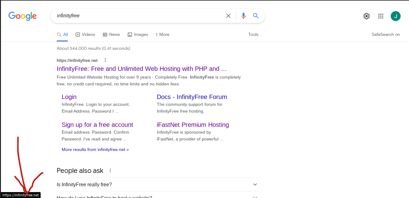

I believe this is an issue with infinity free due to while loading, a redirect box shows up bottom left saying ‘infinityfree net’ like this: https://iili.io/5CE0fj.png
Thanks in advance :slight_smile:
It’s indeed a parking page. We do use parking pages ourselves, but that’s configured through DNS for domains that are not in use. So since you’re using Cloudflare, this would be a DNS error in your Cloudflare configuration.
The only relation I can see here is that your website doesn’t have an icon file, so the browser looks for it at https://critical58.tech/images/favicon.ico , which goes to our 404 error page. It’s not a big issue, and I don’t think this has any relation to the parking page.

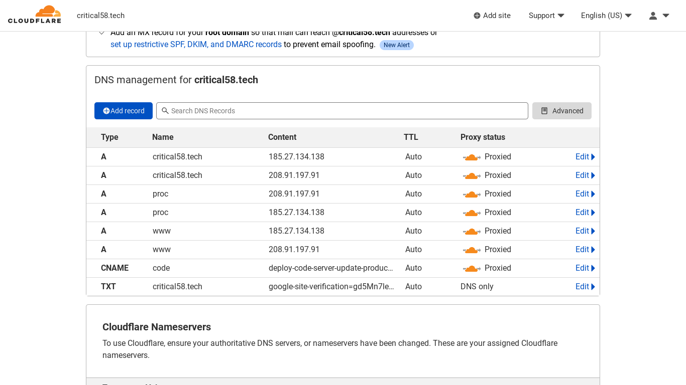

Thank for the advice, should I provide you with my DNS configuration through cloudflare?
Yep! A screenshot would work perfectly.

Here they are! https://iili.io/5nyscP.png
Here they are! (Check the other reply)
Why are there two separate A records for “proc” “www” and “@”? The only “A” records you should have your website are “www” and “@” using the IP in the client area.
I’ve no clue why the other ones were there but I removed them and its fixed!
