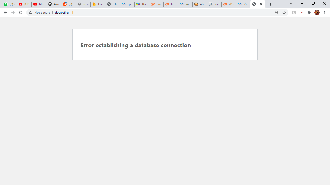

Error update The site first showed itself correctly upon refreshing it is showing this error now.
Since you kept moving the domain, your database credentials are probably wrong now.
You need to login to FTP, find the file “wp-config.php” and edit the database settings so that they match what is stated in the client area.
