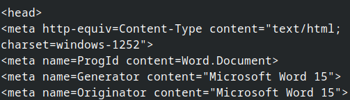

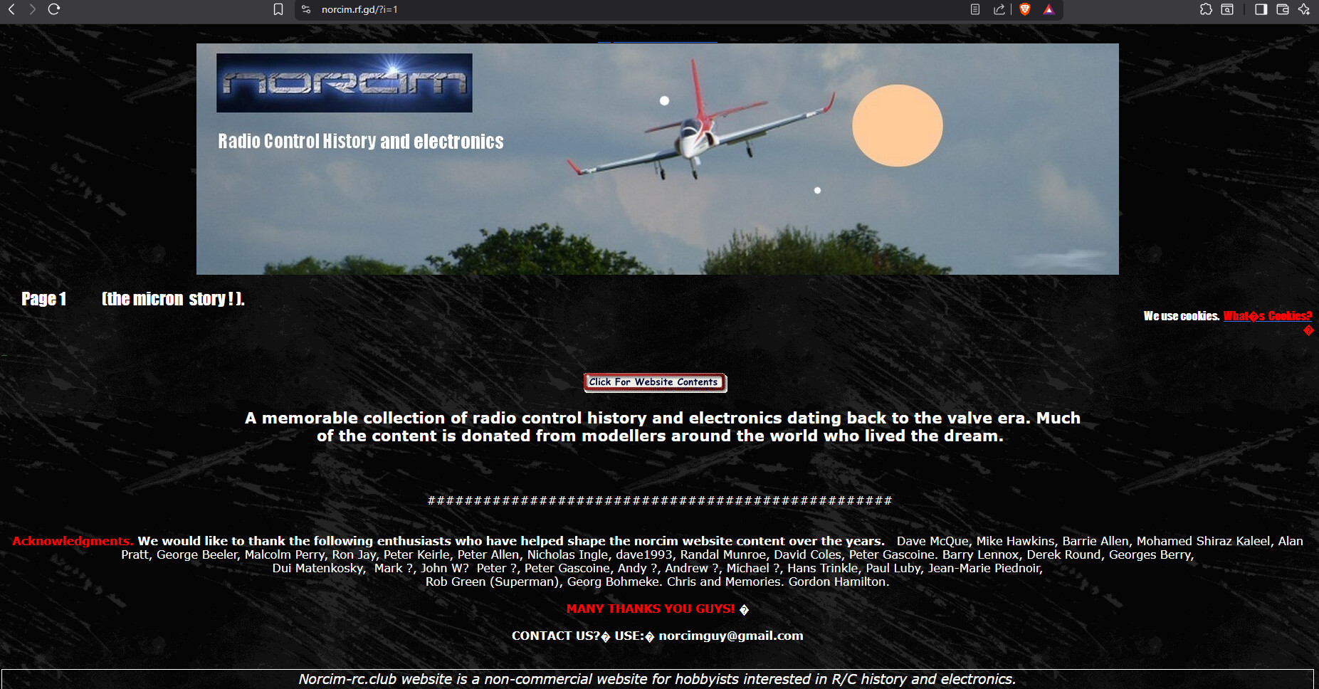

Looking in detail of the text, there are a a a lot of ‘‘?’’ question marks? Look like where ‘spaces’ or commas should be. Original site built with MS Office. Tried two FTP clients both same results.

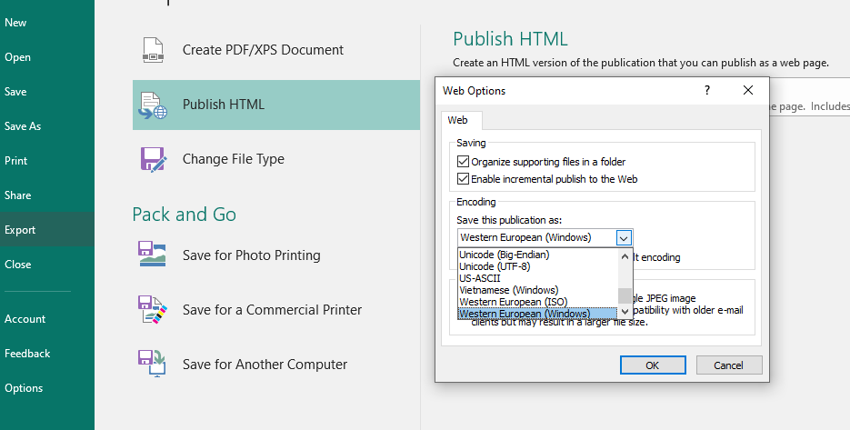

Hi and welcome to the community! This might be an encoding issue. Your charset appears to be Windows-1252 (probably the default). Depending on the application and version you are using for editing the web page on your Windows desktop, select File → Export →Publish HTML→ Advanced Options→Encoding →Unicode (UTF-8) → OK.
Re-upload your files using FTP and overwrite the old ones in htdocs. Kindly verify by opening a new incognito window on your browser if the changes took effect.

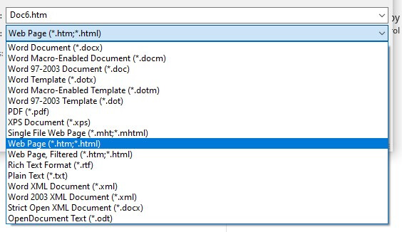

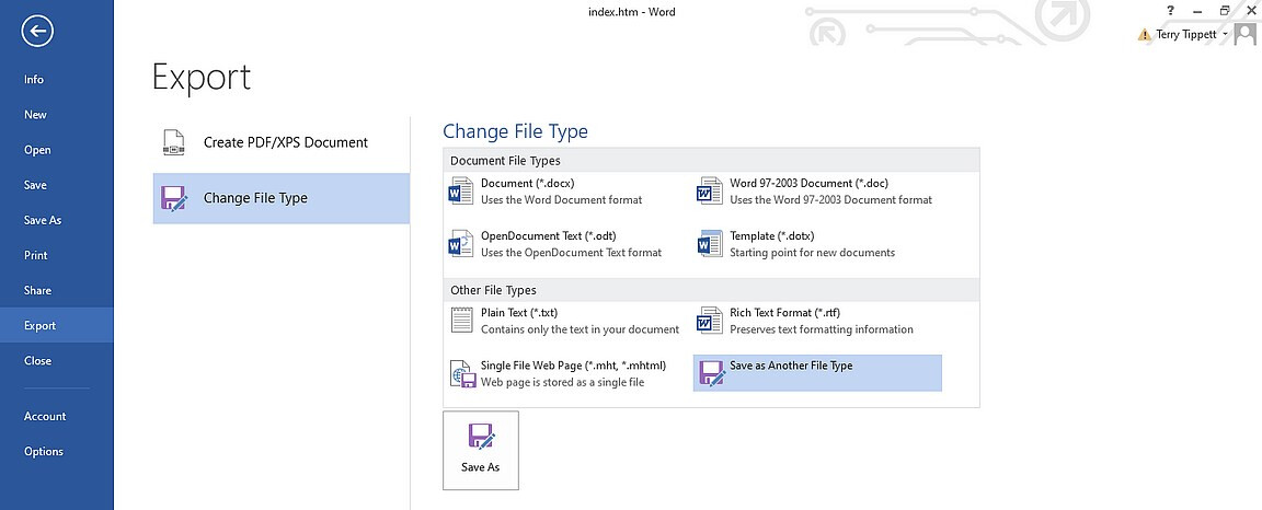

Opening My MS Word File looks like (an old version, 9 years?).

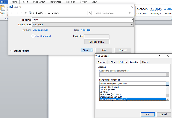

And then when I save the pages for the web it looks like. . . I normally use the Web Page (htm .html).
ONLY ALLOWED ONE IMAGE PER POST SO THIS IMAGE NEXT POST>
I wonder if you could suggest anything with the above?

I haven’t used Word in over a decade myself, but according to this article, you should get a File Conversion dialog box after choosing the export file type:
Alternatively, you could also try opening the HTML file with a text editor after saving it to re-save it with UTF-8 encoding, but that’s going to get cumbersome if you need to do that any time you’re updating your website.

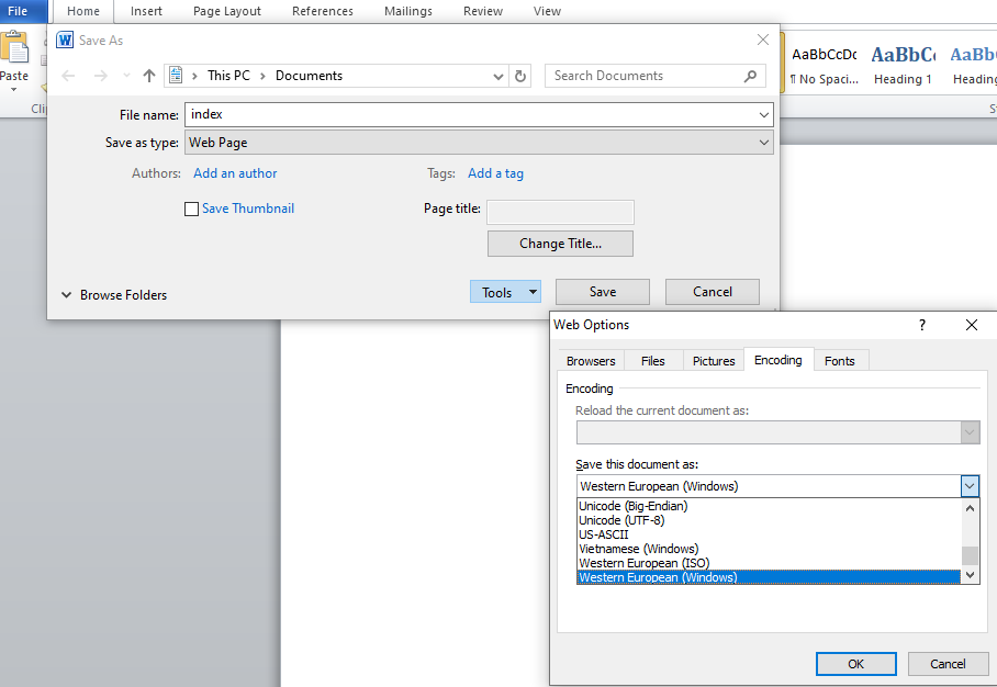

MS seems to be moving and renaming things through the years. The closest here is Office 2010. It is off by a handful of years, but should be near likely: File → Save As → Tools → Web Options → Encoding → Unicode (UTF-8) → OK → Save.
Your site is quite large, so if each one has ”?”, it will take a while to finish. There is an automated way but it will require installing (probably) new applications. Seeing you to get it done soon. Cheers!

For sure, every one has moved on. But I’m revisiting this for technical completeness and future reference. Recreated the dilemma and pondered if there is really a possible way for us, users, to simply put it, just upload and forget. There are solutions already available but all require significant effort, familiarization, or tinkering directly the server files. This is an attempt given with only the limited tools available and the least amount of modification to existing source files.
Assumptions:
  1. User environment and saved files are set in Windows-1252. I have forgotten how MS is the most popular in the world.
  2. InfinityFree is compliant to modern web standards like using UTF-8. Checked it in ftp, file manager (new3), and server.
  3. Human clients are not expected to manually switch (repair) between text encoding when viewing the pages served by IF through their modern browsers.
Possible least effort solution:
  1. Upload all files saved and set in windows-1252 to IF as they are.
  2. Create .htaccess file in the root directory.
  3. Add line: AddDefaultCharset windows-1252
    screen-win06_htaccess
  4. Other forums from Google give slightly different variations but this appears to be the most fitting.

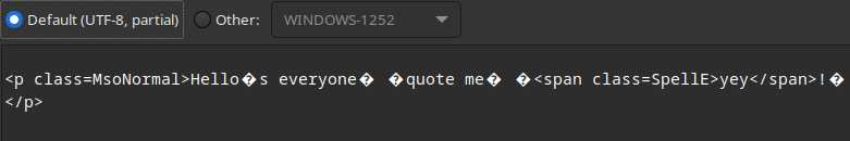

  2. FTP (terminal) and File Manager (new3) display “?” and other funny characters when viewing files.
    screen-win07_ftp_terminal
    screen-win08_file_manager_view

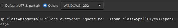

  3. However, the downloaded copies from FTP (terminal) and File Manager (new3) retained their windows-1252 encoding and original characters despite the weird display while viewing in IF server.
    screen-win09_browser
    (This is a downloaded copy from IF via FTP; viewing locally on a browser perfectly now without Repair Text Encoding)
