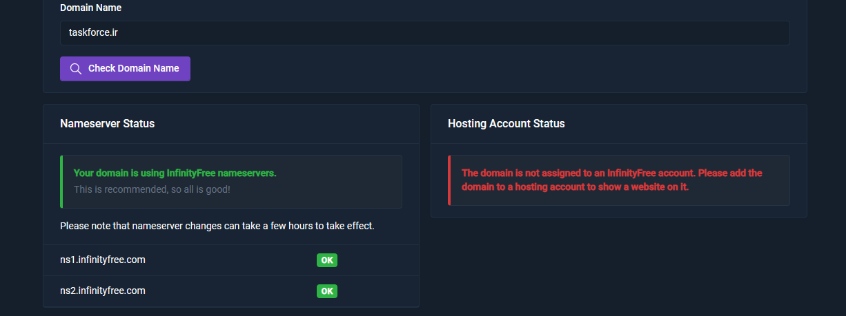

The URL was hosted in infinitytree before deletion by server (due to long absent of me!) and I can’t find any account the URL assigned to. How can I find that?
Welcome to the forum!
I checked your domain but it’s telling me that your domain is not in use in any account.

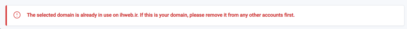

When trying to add your domain via the client area, this is what I see:
It seems your domain is actively used in an account on ihweb.ir. Check if you have an account with them from which you’ll need to disaccociate your domain from; if not, please reply saying so so you can wait for Admin.

@ChrisPAR Thank you very much for highlighting the error message. I never got that.
I test the ihweb.ir hosting (another hosting site, identical to InfinityFree) 6 week ago, and reconfigure DNS back to InfinityFree NSs again.
I forget to remove there. but never get this message in my client area in InfinityFree.
You save me :slight_smile: Thanks again.

You can use the Domain Checker in the client area. If the domain is assigned to an account owned by you, it will tell you which account the domain is linked to.
