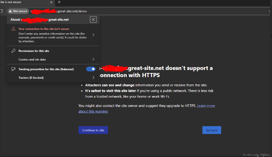

Hello infinityfree team, i copied the .htaccess code exactly as the guide you shared but the redirect from http:// to https:// seems not to work since my site url still displays ‘Not Secure’ and that the site doesnt support HTTPS (check attached screenshot) even after including the suggested code i.e "RewriteEngine On

Check attached screenshot and please advice how to resolve this permanently

The error page you’ve shared seems pretty clear to me: it says that your website doesn’t support a connection with HTTPS.
Enforcing HTTPS on a website that doesn’t support HTTPS is not going to work of course.
However, all free subdomains should just support HTTPS, so it’s strange that your browser says that your website doesn’t.
Would you mind sharing the link so we can check it?
