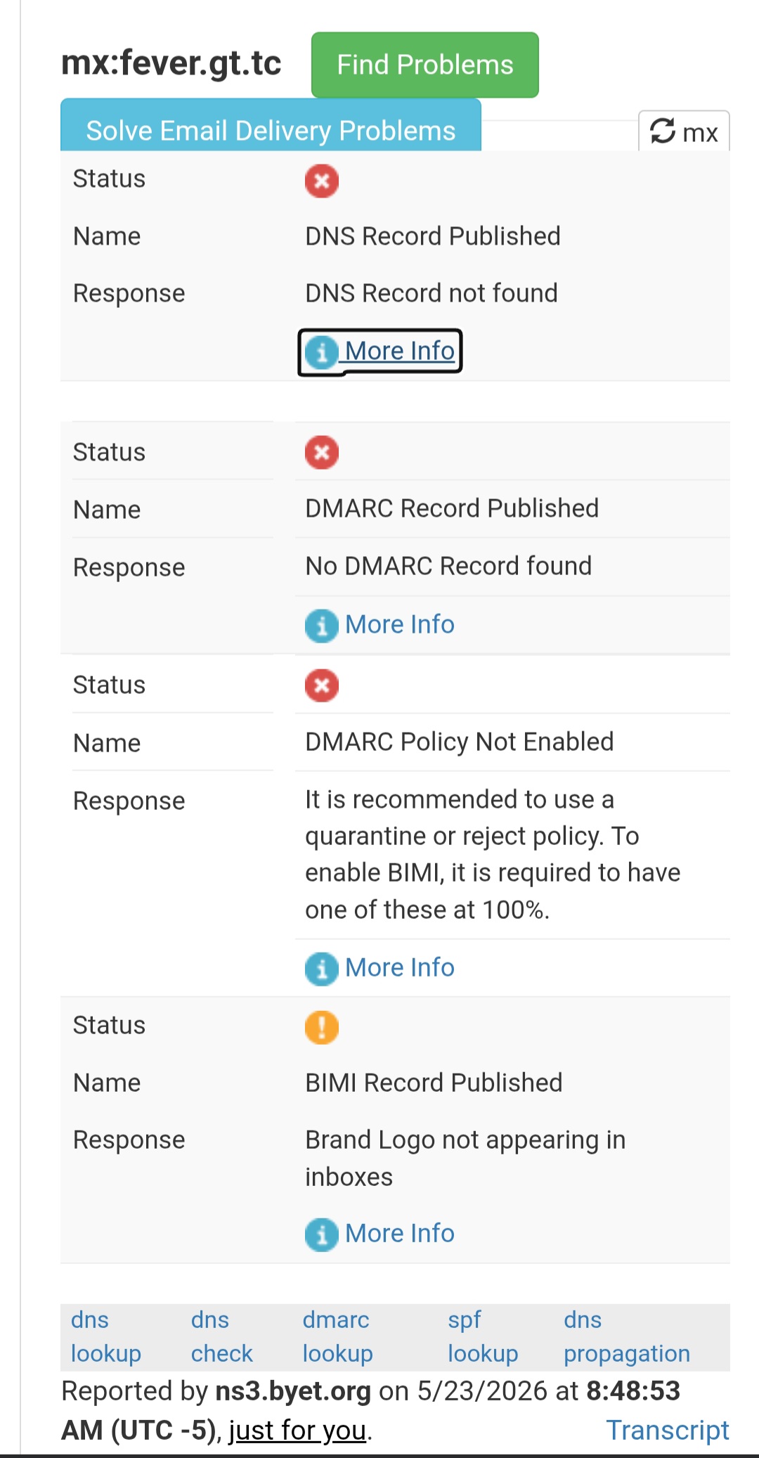

2. MX Toolbox — Says “DNS Record not found”

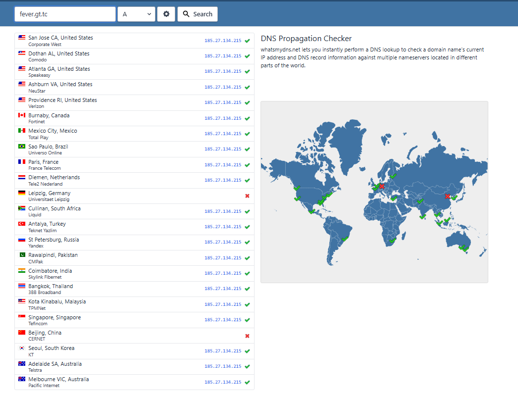

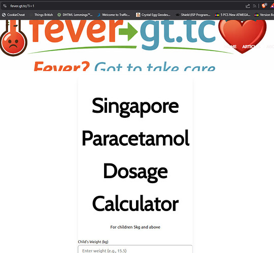

I’ve checked your site with friends across the UK, and can confirm its working here (not that helps much). You say you’ve checked with users gobally? Can I ask where in the world you’ve checked?

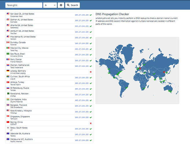

Whatsmydns.net shows that it is accessable at most name servers world wide, with a blip in Bejing and germany

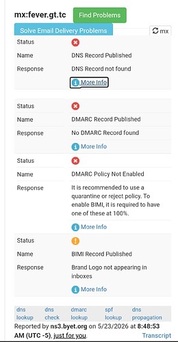

MX toolbox also show’s it as working:

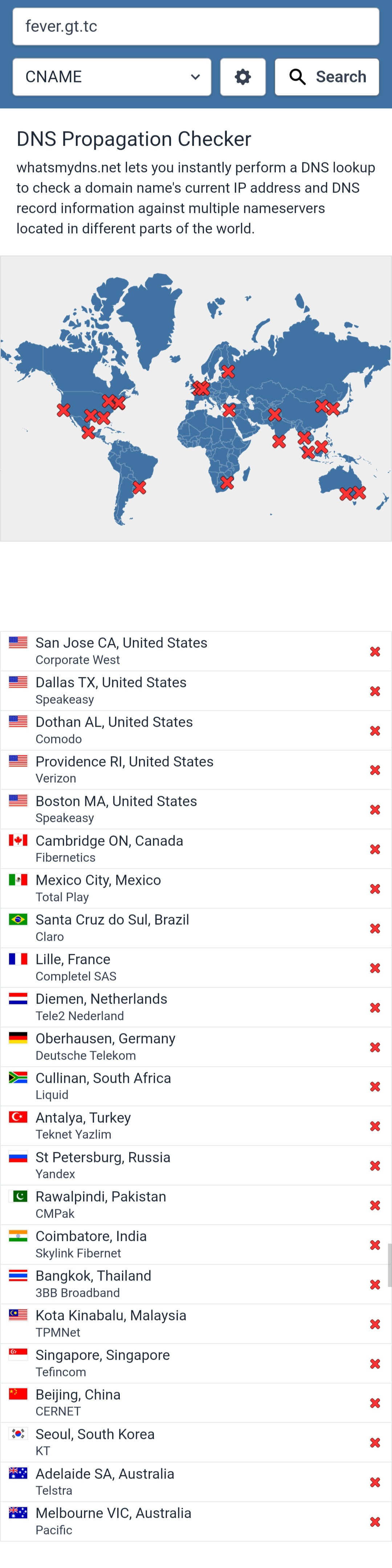

Is my site using A record or CNAME?
When I test with the A record on whatsmydns, it works. But it’s red crosses worldwide once I change to cname.
Can you test:
whatsmydns for fever.gt.tc (CNAME record)
If UK can resolve the CNAME but Singapore can’t, then Singapore ISPs don’t follow CNAME chains properly.
