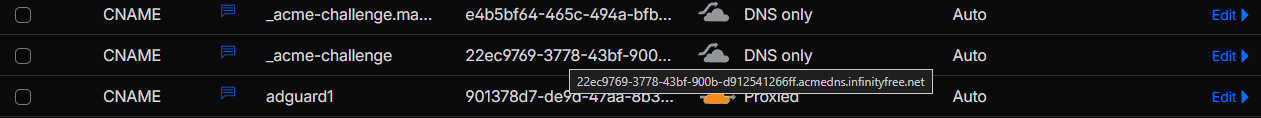

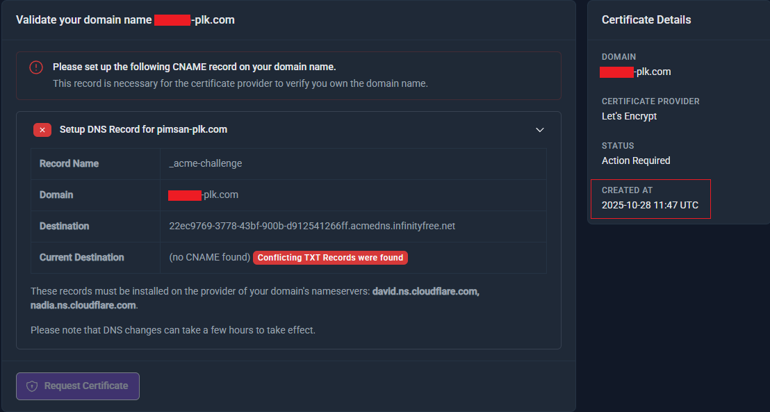

Previously I was able to use SSL without any problems for I think 2 years and I did not change any information about Cloudflare and Infinity Free records for SSL but now I am having a problem that I cannot request it. I have tried deleting records in Cloudflare and clearing all cache and also tried deleting SSL request to request again several times and now it has been waiting for more than 3 days. Now I don’t know what to do.

The problem here is that Cloudflare provisions hidden TXT records on their end to be able to obtain their own SSL certificates. These are the SSL certificates used to secure the connection between your visitors and Cloudflare.
Changing the SSL mode only controls if the connection between Cloudflare and our servers is encrypted. It’s completely unrelated to the issue you’re having. Using Full Strict SSL works fine, provided that you have a valid SSL certificate on your hosting account. But Cloudflare is making that part complicated.
I think that these are your options:
  • Switch from Full Strict mode to regular Full mode, and delete the currently installed certificate. The connection between Cloudflare and our servers will be encrypted using a self-signed certificate from us.
  • Wait for Cloudflare to remove the TXT records on their end so you can obtain your SSL certificate from us. My guess is that it might take a few days, but that’s just a guess.
  • Contact Cloudflare for further assistance. They are overruling your own DNS records, after all.
