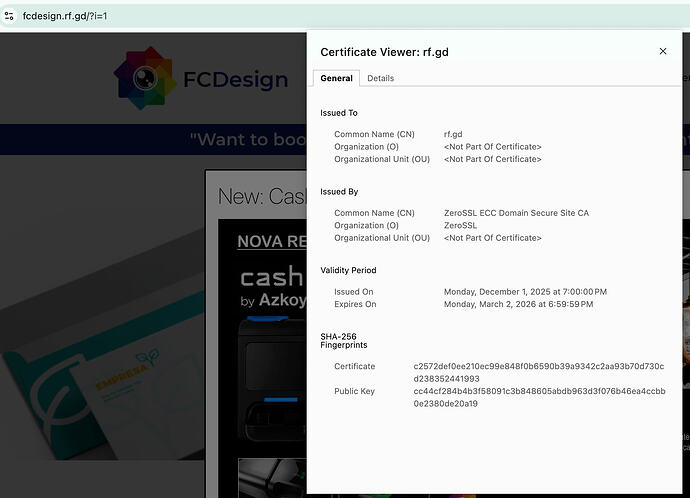

Right now I’m using a ZeroSSL ssl certificate valid only for 90 days. It was the only solution I found to make my site appear safe for those who visit it

Looking at your domain in an SSL checker, it looks like you are covered by the wildcard SSL certificate though.

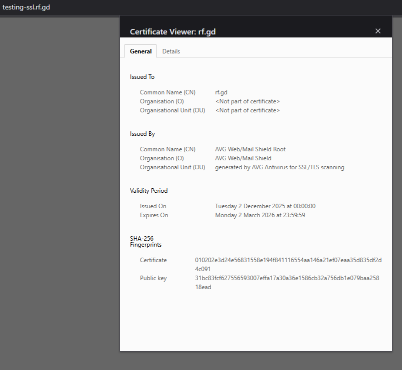

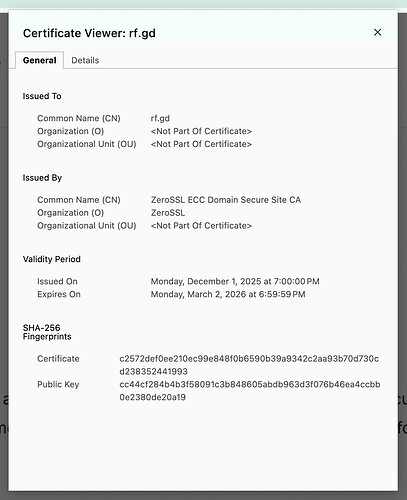

This is mine, which as you’ll see is the same certificate with the same serial number.
–edit–
Updated with better images

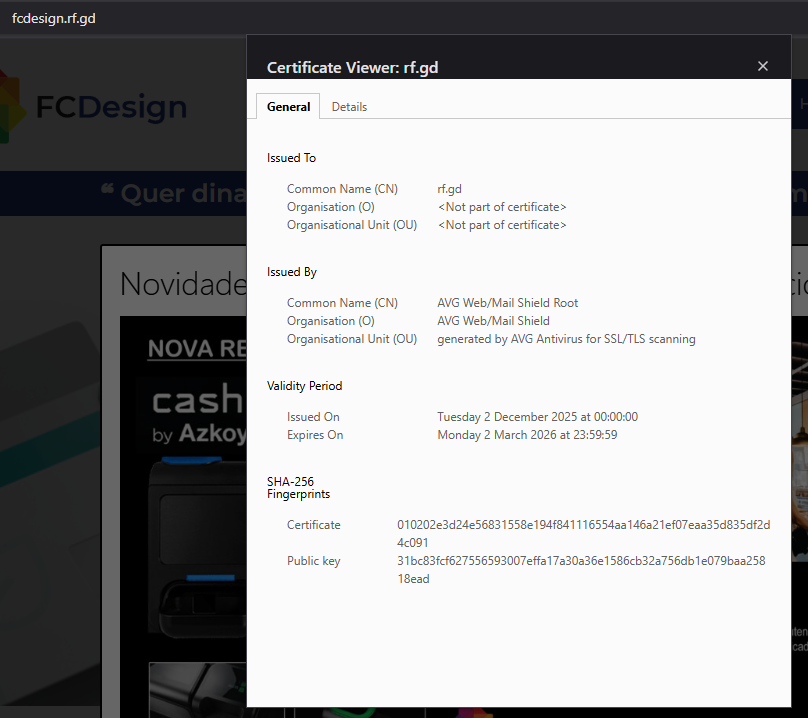

@dan3008 You seem to be browsing with an antivirus, since you have “AVG Web/Mail Shield Root” in the “Issued By” area.
The user should compare the Certificate and Public Key against this one, since I don’t use any antivirus software.
And it seems to match.
