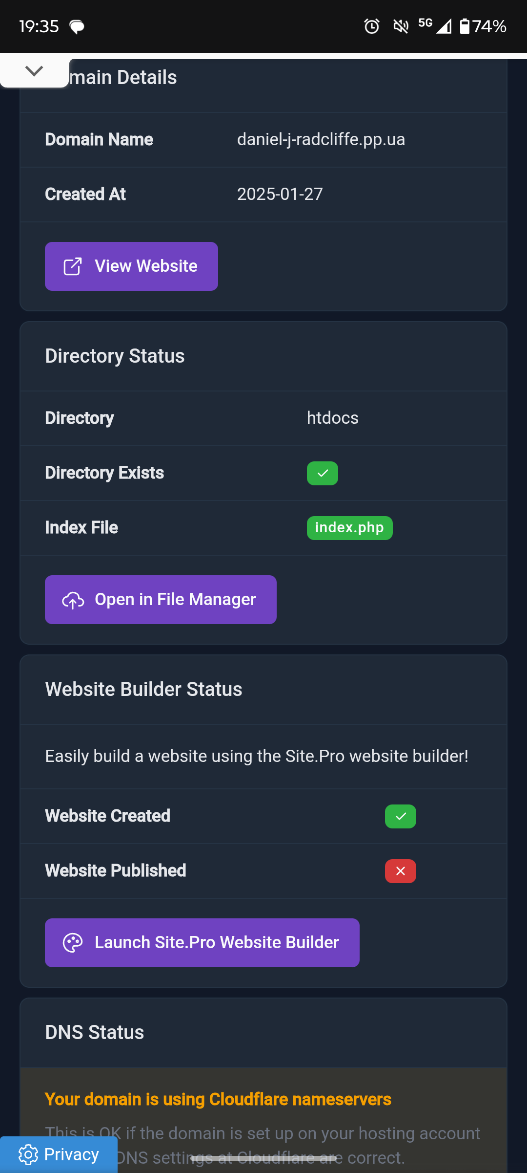

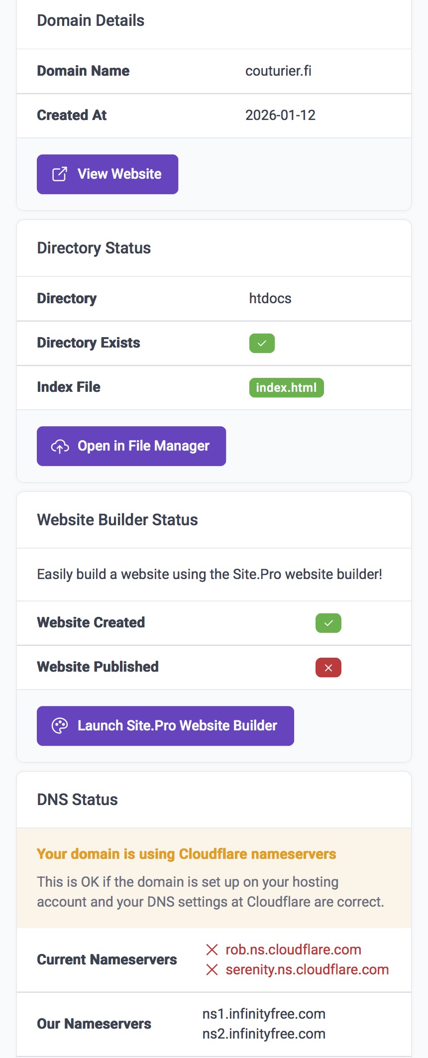

On your dashboard you should have a screen that looks like this
I’m guessing the index directory and file are showing correctly?
Yes, that is correct

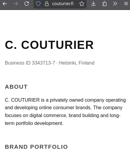

My website was again up for few days without any changes and now it seems to be down giving the same error.
Hello. Got this from a different network.

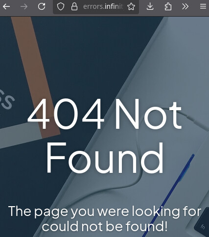

Also, it may not be related but as far as I know InfinityFree 404 looks something like this:
Kindly post here again if problem persists, so somebody else can check.
Because that is the InfinityFree 404 page. It’s customized.
What OP get is the iFast​Net/MyOwnFreeHost 404 page, the absolute default.
