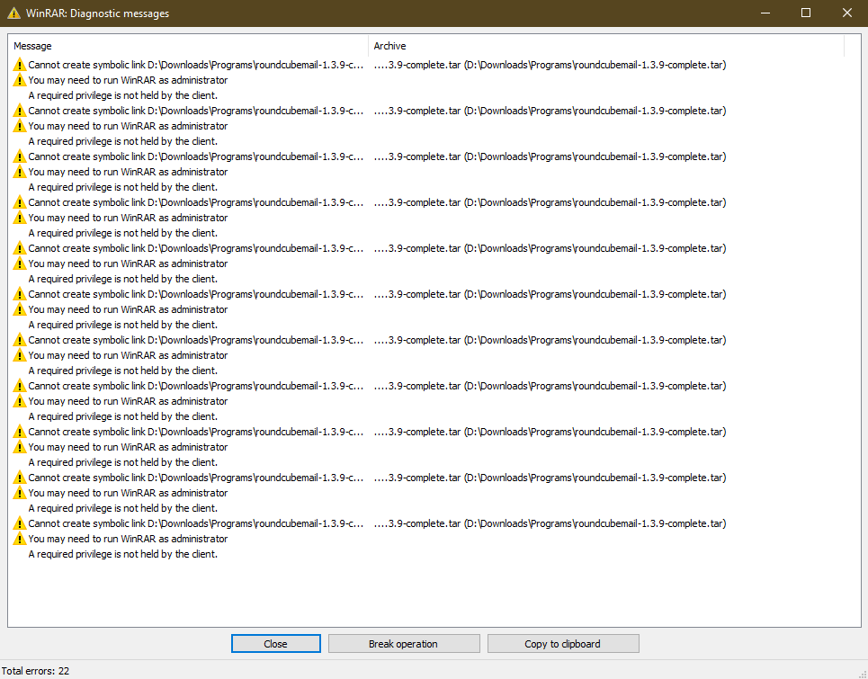

But I am facing same issue with RoundCube even with winrar
Try downloading the latest version of RoundCube from here and extract it with WinRAR.
The logs say, “You may need to run WinRAR as administrator”, so try running WinRAR as administrator and extract the tar.gz file in another folder.
