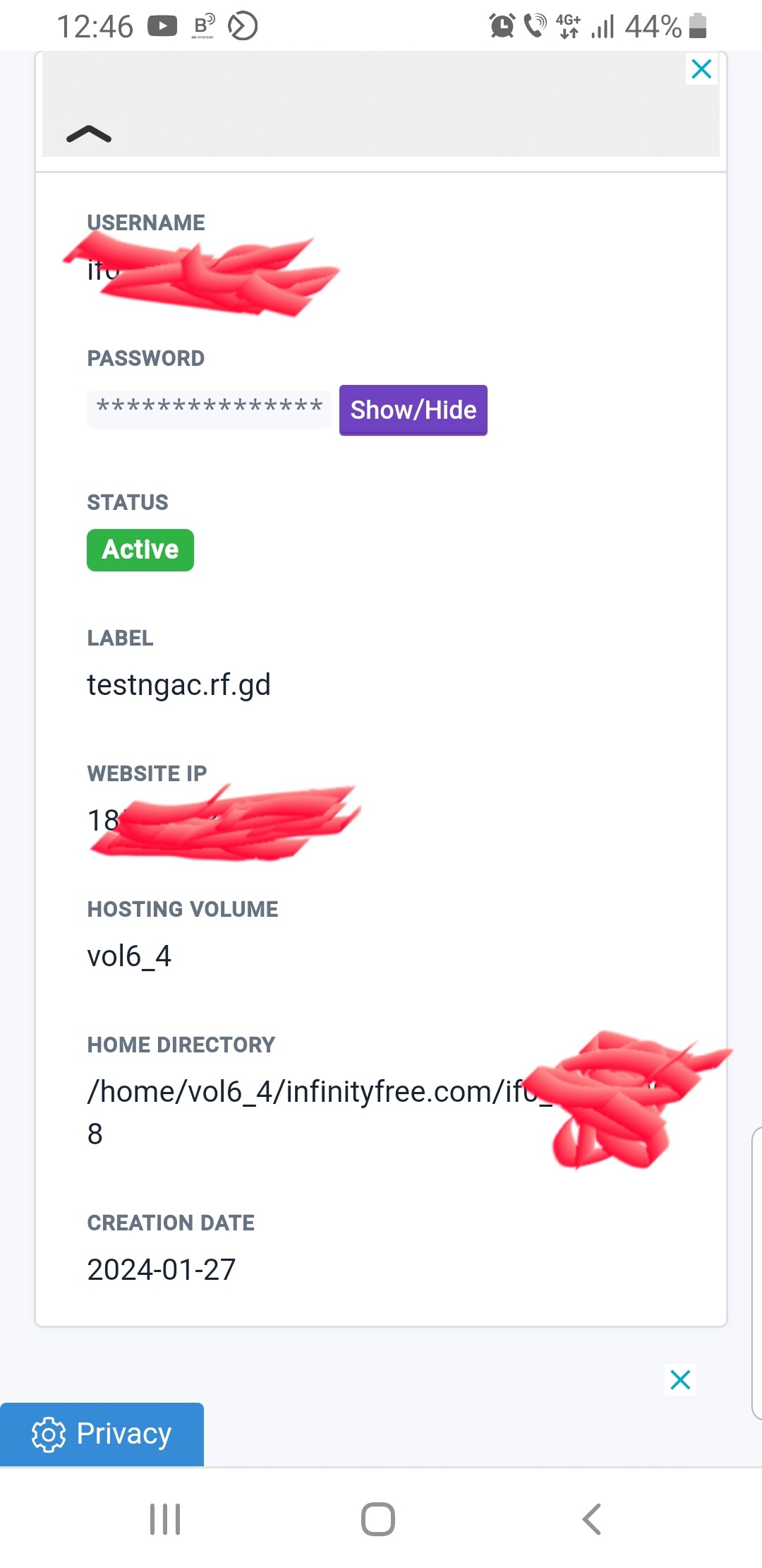

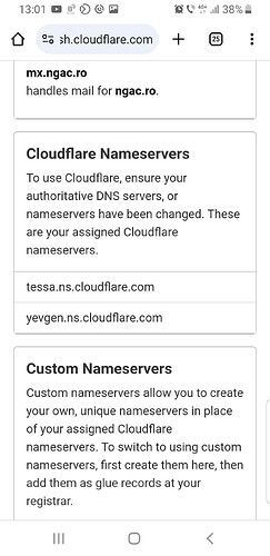

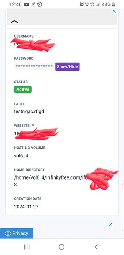

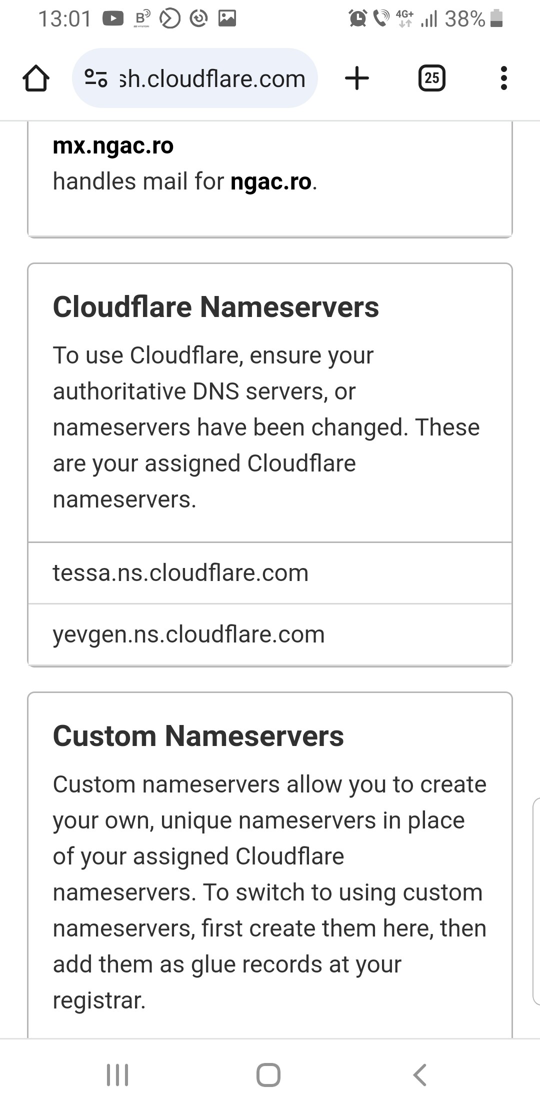

Can you tell me please, how can I find the ip, for step numer 8 from the tutorial, if ngac.ro is not showen on the infinitydashboard? Should I use the ip for testngac.rf.gd from the second print-screen? Thank you.
Yes. Since this is the hosting account ngac.ro belongs in, this is the IP you should use. IP addresses are assigned per hosting account, not per domain.
You’ll also need to decide if you want to use Zoho, or ImprovMX. You can use one or the other, but you can’t use both. It seems you want to proceed with adding the DKIM record, so I’m guessing you have your mind set on using Zoho mail via Cloudflare DNS.

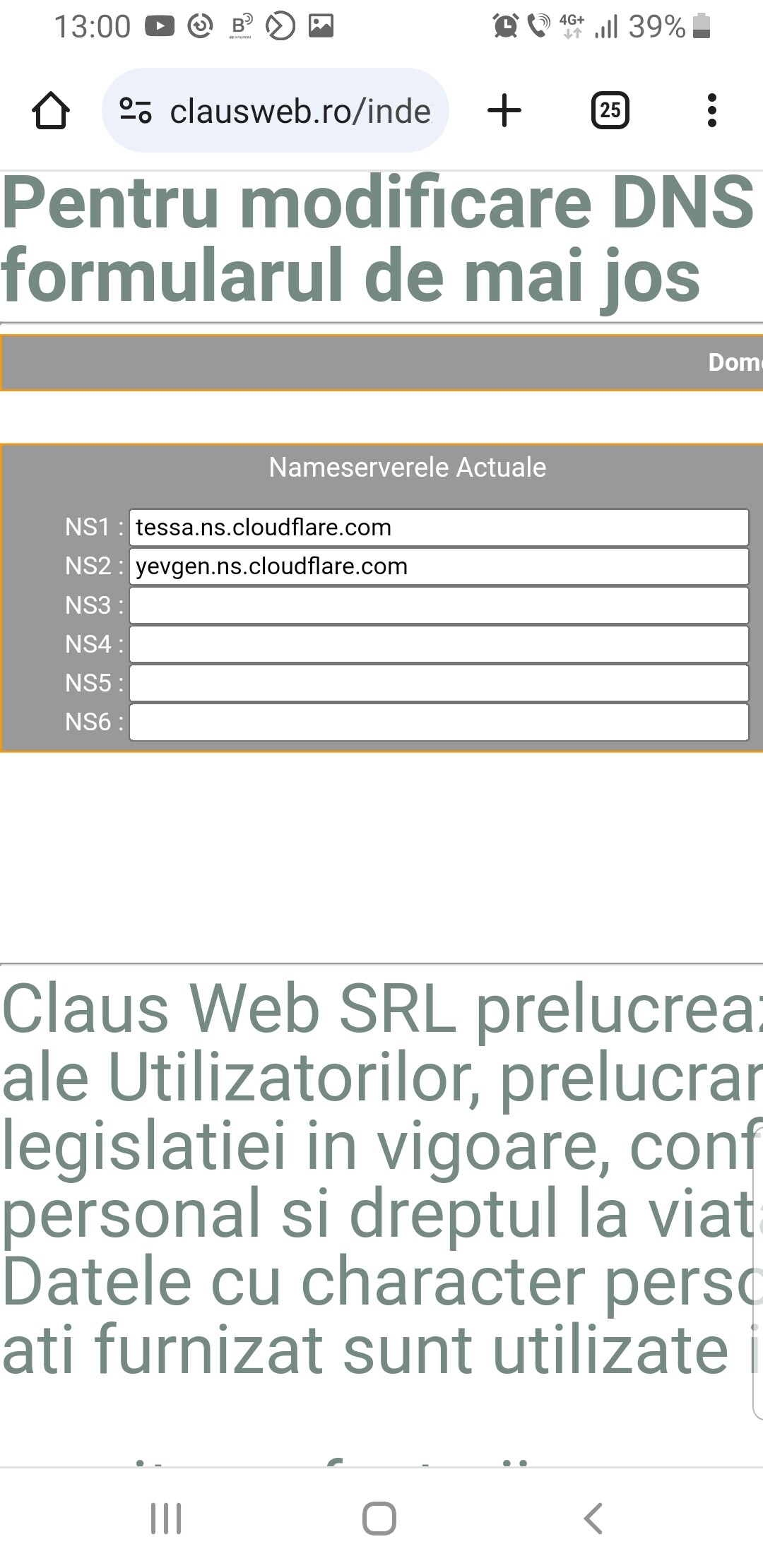

Ngac.ro is not working since I changed the nameservers in my registrar,
from infinityfree to the ones from cloudfare. Probably it will work again, after I will finish the configuration from the tutorial?

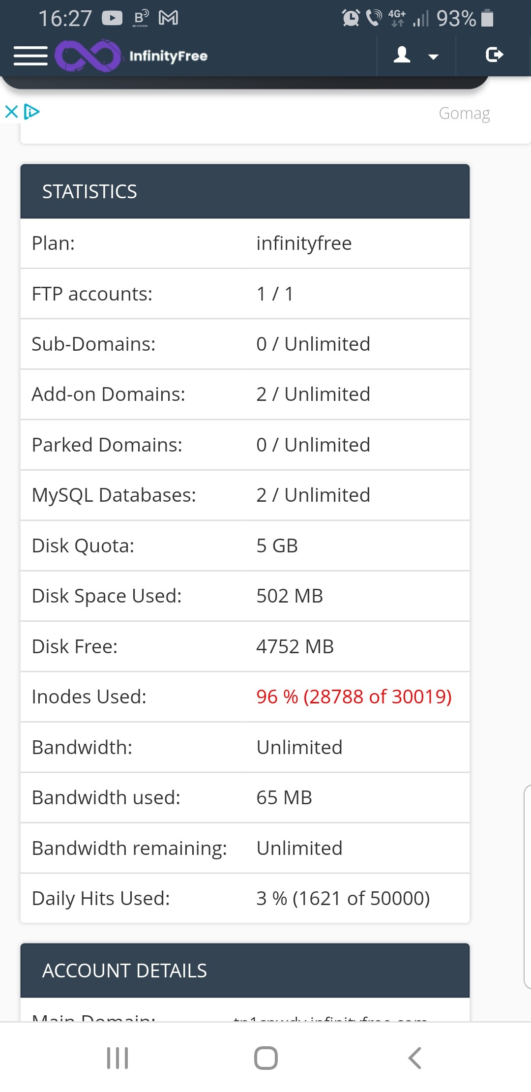

What does it mean “Inodes Used:” ?
How can I decrease them?
What will happen when Inodes Used, will go to 100%, they are already 96%? Will the site work any more? Will I have to pay something when reaching 100%? If yes, how much?

All of these questions and more are explained in detail in this article:
Please check the knowledge base before posting next time, it contains a lot of useful information.

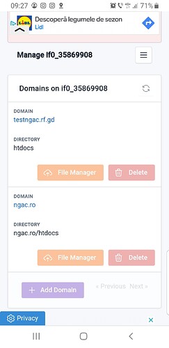

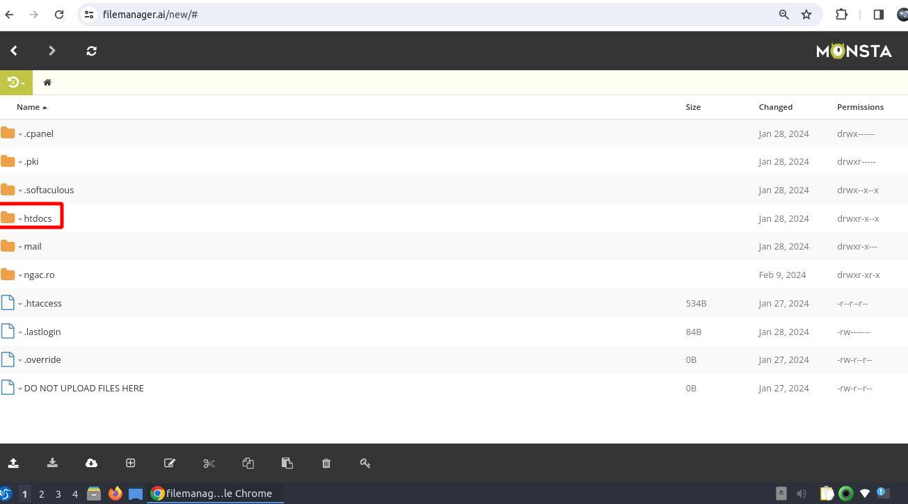

In order, to decrease the “Inodes Used” can I delete the htdocs folder, the one circled with red from the next print screen:
Thank you.
The htdocs folder is containing the files of your first website, testngac.rf.gd. If you have copied the contents to your ngac.ro website (so, the domain is not parked), and you no longer need that site, you can remove the htdocs folder as you show.
I’d still recommend taking a backup beforehand, just in case something goes wrong.

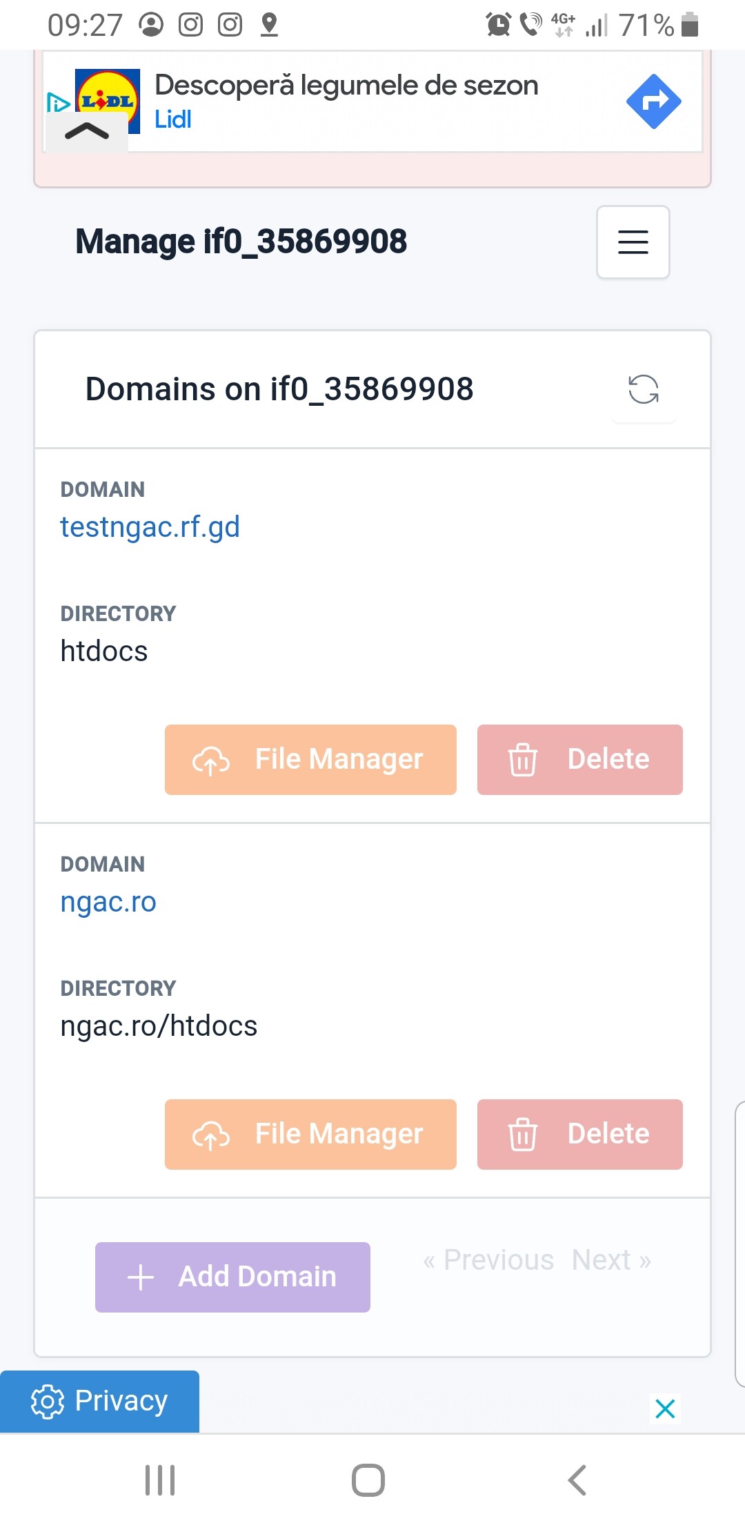

Please have a look at the Domains screen in the client area. Is there no domain linked to the main htdocs folder? If so, it’s safe to delete.
Ngac.ro is not working any more.
I whant to delete, the main htdocs folder, because I don’t need it, any more.

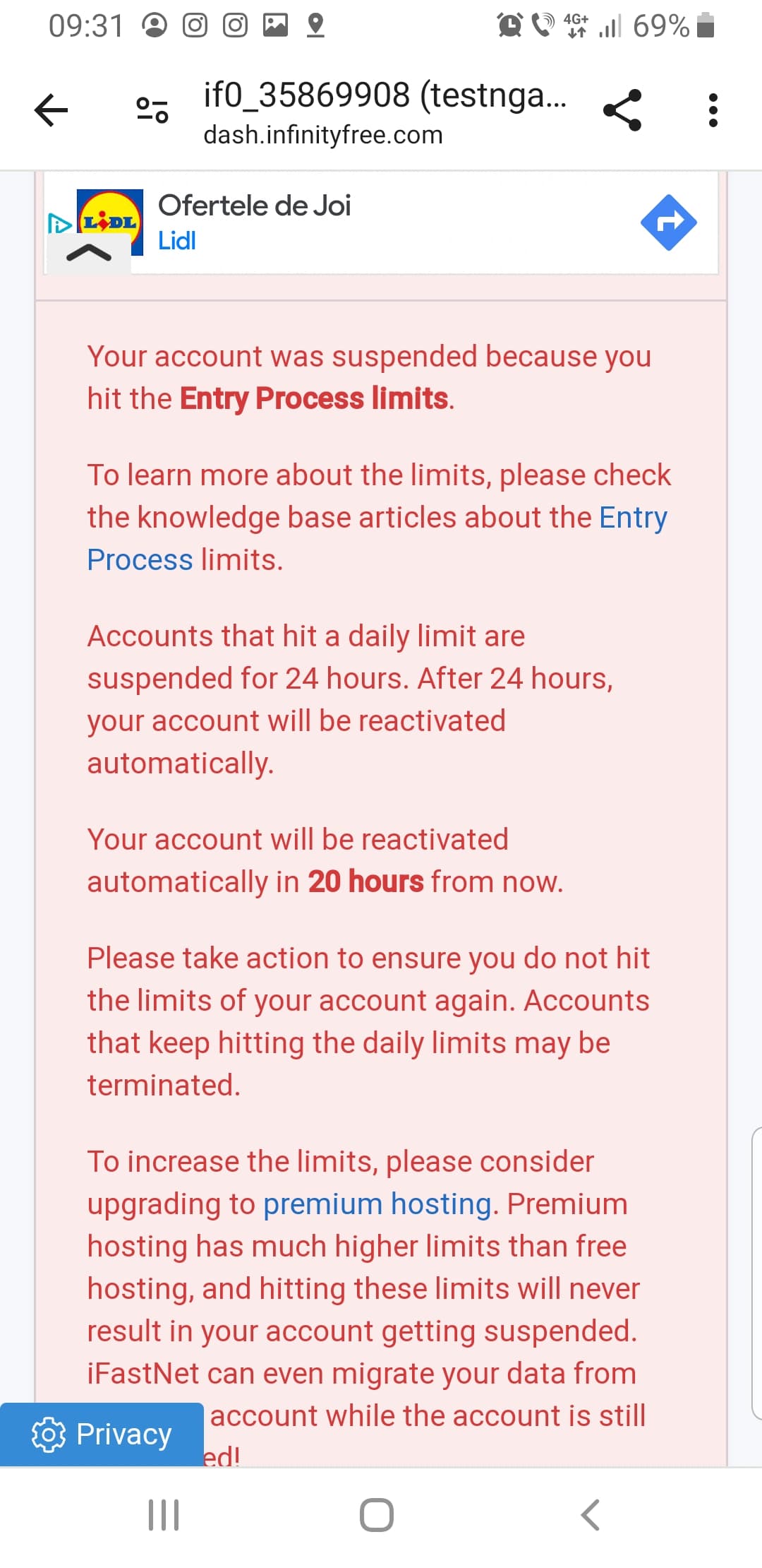

I can not do this, because:
Hi,
Your InfinityFree account if0_35869908 (testngac.rf.gd) has been temporarily suspended.
Your account was suspended because you hit the Entry Process limits.
To learn more about the limits, please check the knowledge base articles about the Entry Process limits.
Accounts that hit a daily limit are suspended for 24 hours. After 24 hours, your account will be reactivated automatically.
Your account will be reactivated automatically in 23 hours from now.
Please take action to ensure you do not hit the limits of your account again. Accounts that keep hitting the daily limits may be terminated.
To increase the limits, please consider upgrading to premium hosting. Premium hosting has much higher limits than free hosting, and hitting these limits will never result in your account getting suspended. iFastNet can even migrate your data from your free account while the account is still suspended!

Is there any way, so I can delete htdocs, earlier then 20 hours, in order for ngac.ro to work? Thank you.
No you can’t, you need wait after the suspended time.
The reason your domain ngac.ro is not working is because the hosting account is suspended. You cannot delete your htdocs directory while the account is suspended, but even if you could, it wouldn’t make your website work.
@Admin can you give please, more details, why hosting account is suspended? Thank you.
You already know why:
