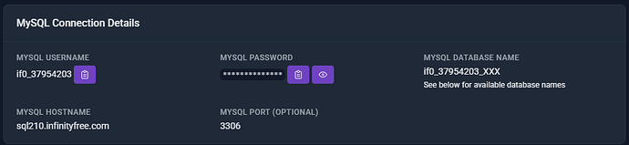

your Hosting account password isn’t the same as your SQL password.
in your dashboard go to your SQL section and its at the top:
