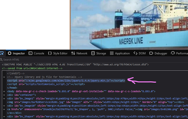

I see multiple jquery scripts there… they have different name and file sizes…??

you can’t call multiple jquery in your HTML (2 of them)
that’s why I told you to delete that line
and you did not delete but modified and added a new one which again calls a new jquery

with respect sir… these are not the same… they are different sizes,and names .
One is jquery_1.js at 70.4 kb the other is jquery_012 at 76.7 kb
And as i previously mentioned there are another 12 jquery scripts in the html…
but contain the basic jquery code inside (open each with a notepad and see )
and because of that it clashes (rounded in the pictures above )

See you have two versions of the jquery script (look at the names)
And if you want to have multiple versions at once in some HTML
then you also have to change your code
and invoke separate versions there
So instead of
$('#selector').function();
you’d do jQuery_1_4_4('#selector').function();
or
jQuery_1_4_2('#selector').function();.
Or use
jQuery.noConflict()
But why so many complications for some slider ???
why would visitors download 140KB (2 versions of JQ) just to rotate a few images in a slider ?
It’s not normal and it just chokes the speed of your website and causes conflict between scripts
With regard to the lines to delete as shown in your screenshot…
My File manager sees differently.
This is lines 182-192 as per my view… it is quite different from yours… and no…
i did not make any changes to the code as you suggest.
It could be the newer vsn page for some reason has different code?
See below
Sir pls advise which jsquery to delete… 1 or 12 or does it not matter?
Lines 182-192.

Delete this line
if you don’t know how to simply erase that line (up)
go to the Client Area and there you will find the File Manager (monstaFTP)
  1. Find your index.html with it (with monstaFTP)
  2. right mouse click on index.html and choose EDIT
  3. find that code/line and delete it
  4. click save button
  5. then visit your page (domain in the browser) and press CTRL + F5 just in case

I hv deleted that line googl apis…
It runs offline as usual… but still not from the website.
I notice the Action scripts also do not work…
Is there some common reason do you think

slideshow works !
wait 7 sec until it starts (+ DOM ready)
if you do not see the change press CTRL + F5 (while you are on your website with browser)
