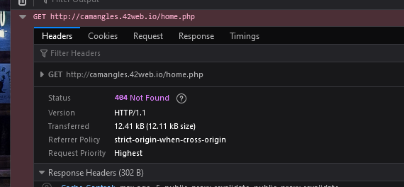

It shows error

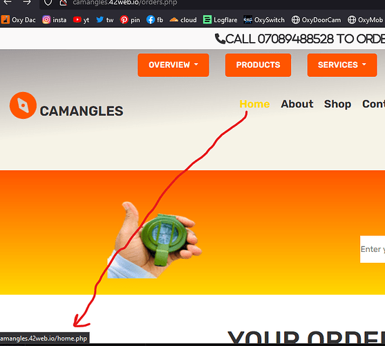

Everywhere in your menu there is old code that leads to home.php
and since you renamed home.php to index.php, that file cannot be found
FIX
