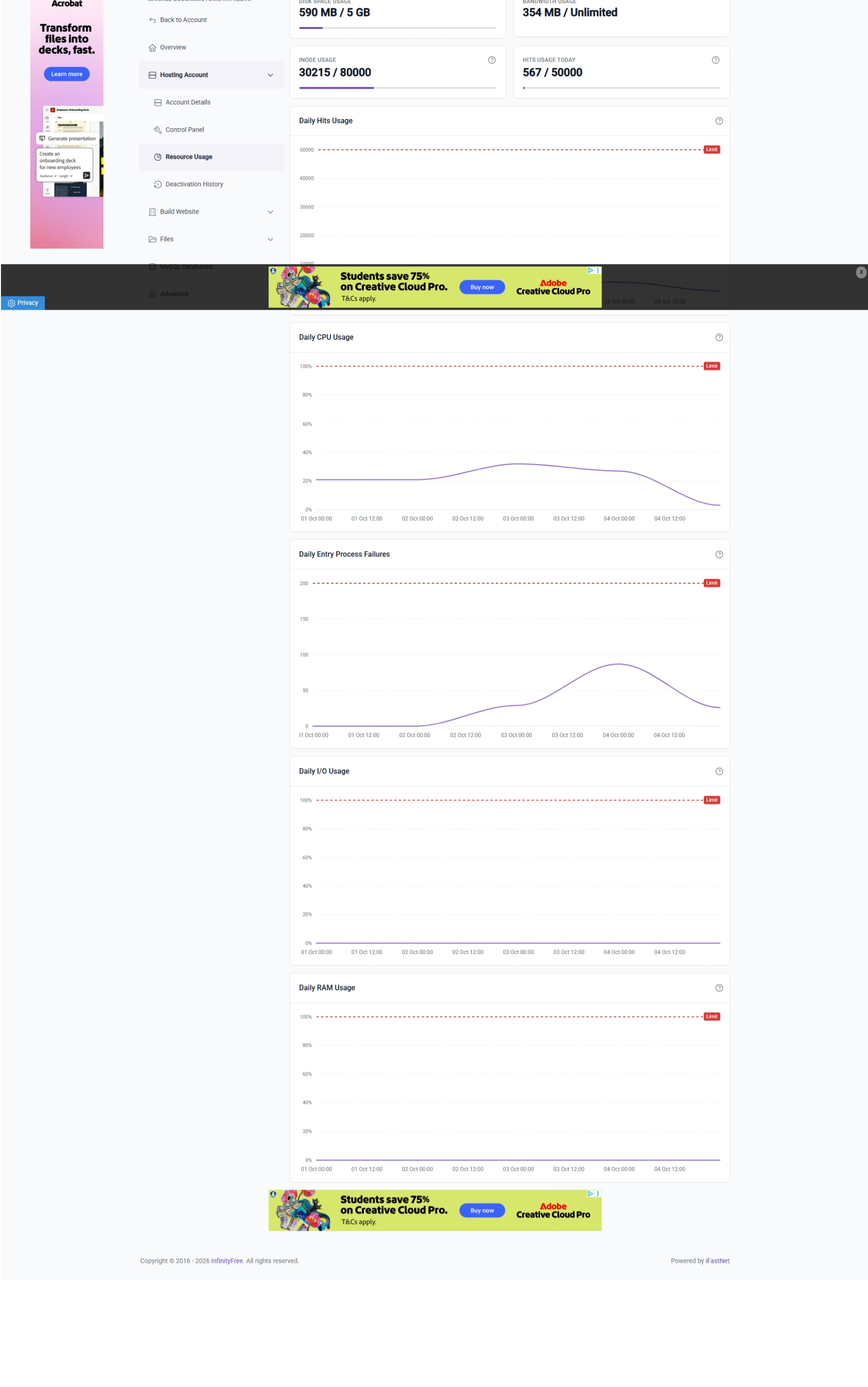

  • The account has shown Active with disk space, inode usage and daily hits below their limits. The resource charts we could see did not cover the incident time, so they cannot rule out a resource problem at that time.

I have checked the stats for the site and nothing goes above 40%

A 502 error from multiple websites on the same account is indeed not a code issue, that sounds more likely to be a resource issue to me.
The graphs show daily usage, but in addition to the limit per day, there are also limits on how much you can use at any single time. So a temporary spike in website activity, or just some heavy code hogging all your account’s resources, could potentially trigger such errors.

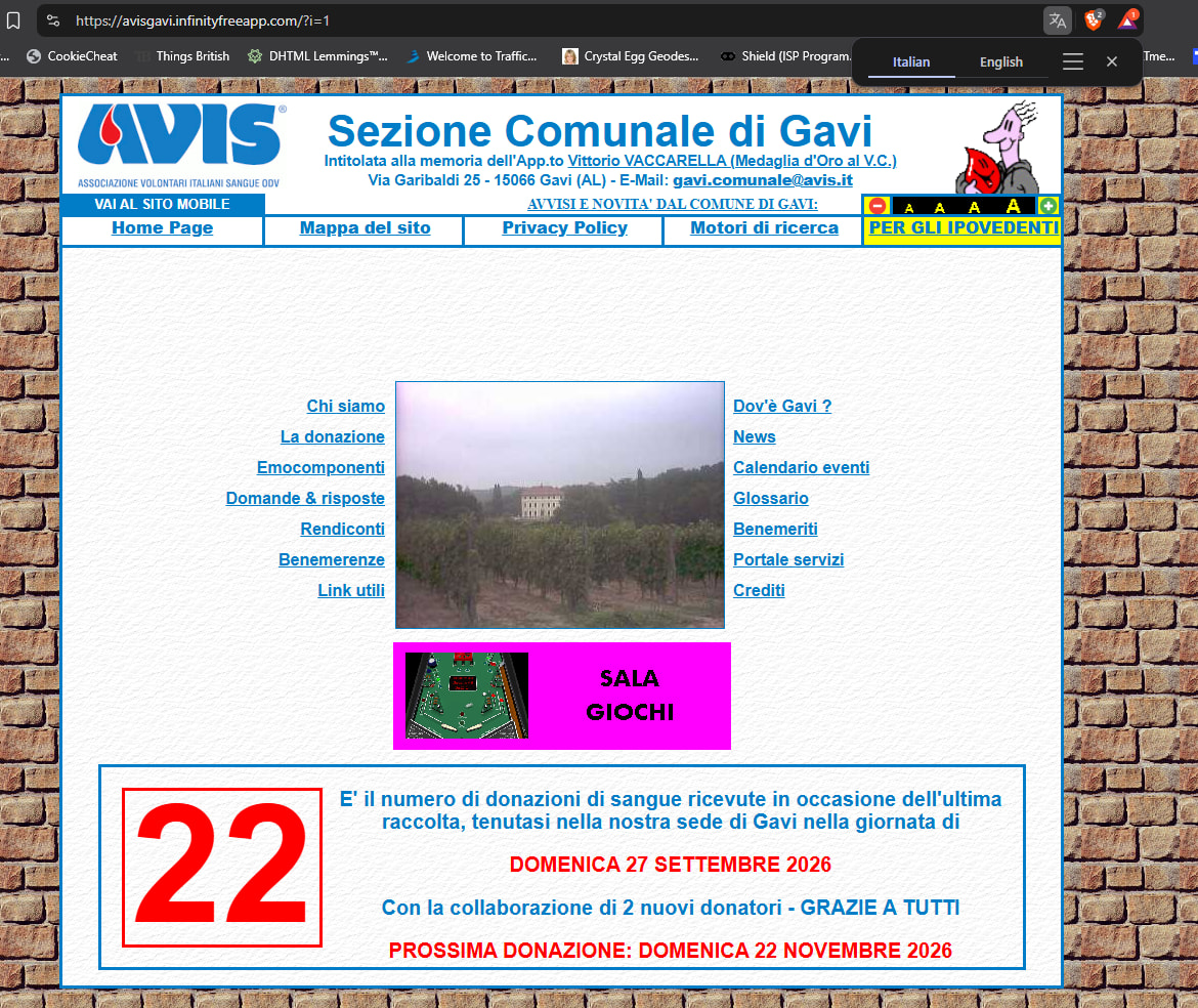

BTW: I’m experiencing the same problem in my site (https://avisgavi.infinityfreeapp.com), which DOES NOT use WordPress
@The_AVIS_cat yours is working for me… try clearing cache and se if that gets you back in
