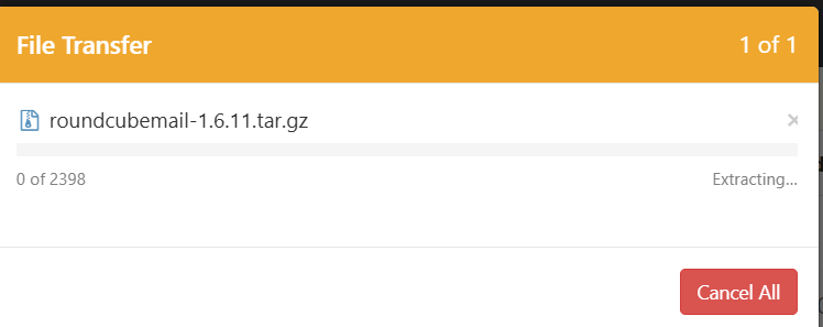

It does not extract
Please extract locally then upload with FileZilla

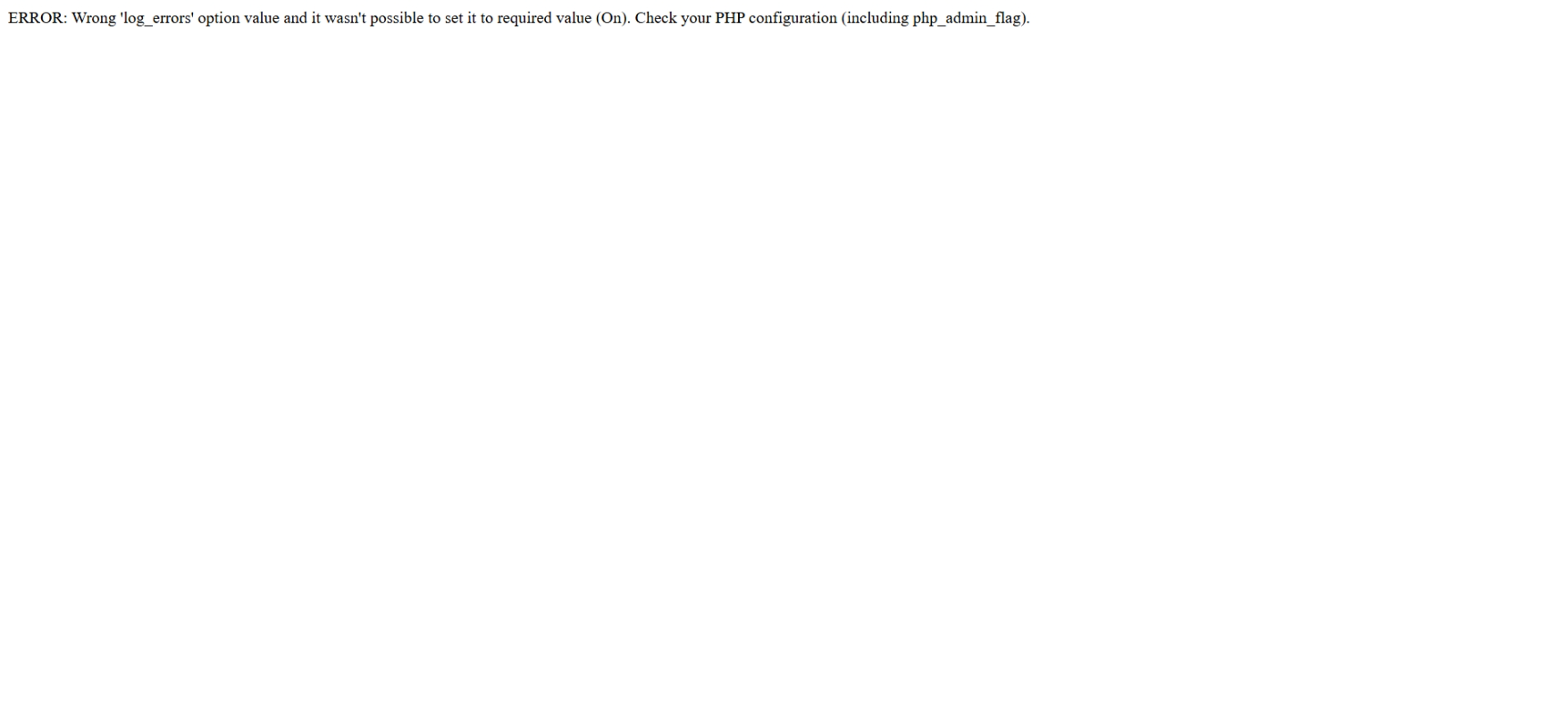

Alright i installled it and now i get this error how to solve

I’m pretty sure that RoundCube doesn’t work on our hosting. We had to disable IMAP functions on our hosting due to rampant abuse (the majority of accounts using it were using it to try and break into other people’s mailboxes).
As for the log_errors issue, that’s a very weird issue from RoundCube to have. We don’t have it enabled because error logging was too costly. But for RoundCube to completely refuse to function because of that is a very strange design decision. It’s up to the server and/or website administrator to decide how errors are handled, not the application developer.

But is there any way to remove the log_errors I just want to get into the roundcube administration panel
Personally, I’d stick to FileZilla or the official file manager, as these are known to work (although the official one is buggy)
It should be possible, but it probably requires modifying the RoundCube source code. It’s an option if you know what you’re doing, but I wouldn’t recommend it.
And also keep in mind that both @dan3008 and I already told you: RoundCube probably won’t work on our hosting to begin with due to IMAP functions being blocked.
I’m not sure exactly what your end goal is to setup RoundCube, but my recommendation would be to find another solution for this that doesn’t involve hosting RoundCube with us.
