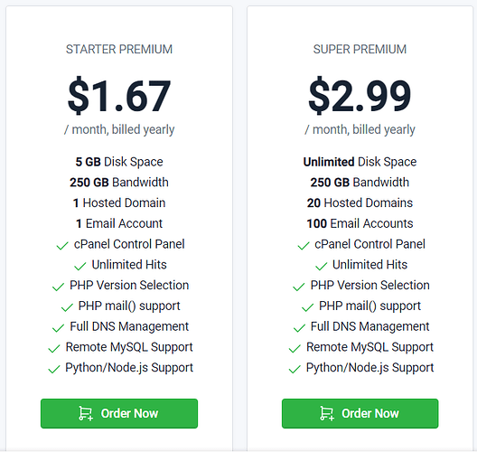

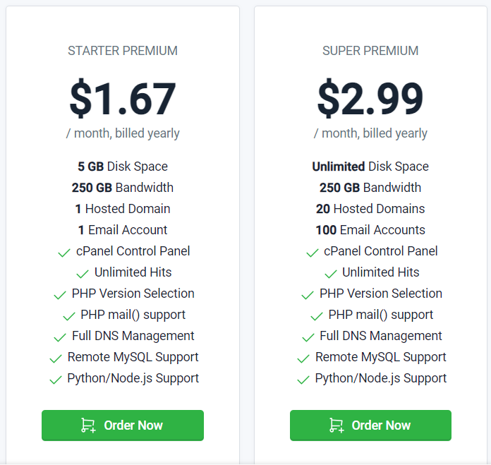

Am I right in thinking that any of the paid-for options available here don’t include the javascript security challenge? Depending on where I click on “Premium” on the InfinityFree website, I’m taken to the iFastNet page (minimum cost $4.99/month), or another page mentioning iFastNet Super Premium ($3.99/month) or the “Upgrade” page which mentions Starter Premium at $1.67/month as per the image I’ve hopefully attached.
Aside from this annoying failure to post when a visitor’s IP address changes, I also don’t like the javascript requirement meaning that the site is not indexed properly by search engines, and the inability to use Open Graph link previews. So if all of those issues are solved by ANY of the paid options, I might go in that direction. Thanks!

Yes, all paid plans do not have this security system.
The pricing can be a bit confusing, but, in a nutshell:
  • The “regular” price for a Super Premium is $4.99 per month, billed month to month.
  • If you get the plan without “free” domain, it becomes $3.99 per month (yes, I’m aware, I don’t make the plans).
  • If you order for a whole year, it effectively becomes $2.99 per month.
Yes, iFastNet’s plans are quirky, and the way they present pricing on their own site makes it very unclear what you’re saving by going for a yearly plan (it’s $1 per month on all plans).
Besides the IP address changing issue which has been fixed, the browser security challenge does not affect search engine indexing. We’ve made special precautions to make sure they are not affected.
The only real issue is that OpenGraph previews do not work. You can decide for yourself how much those are worth to you.

So with that likely resolved, I’m less likely to go to a paid version now, but is the $1.67/month option not actually an option?

All of the paid plans are an option, of course, I just wanted to let you know that free hosting is better than you thought it was.
