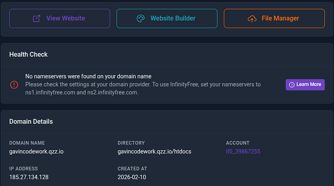

How to remove?
"No nameservers were found on your domain name
Please check the settings at your domain provider. To use InfinityFree, set your nameservers to ns1.infinityfree.com and ns2.infinityfree.com.
" I want to remove the warning from my domain health info thing, the nameservers right now are cloudfrare and I want that warning to don’t show up. It ok if it not possible to remove unless I set it to Infinityfree.
Once the checker detected there cloudflare name servers, it’ll change to say that it’s found them, and to make sure that cloudflare is set up correctly
The qzz.io nameservers are notoriously buggy. Of the four nameservers they have:
  • ns1 works but also operates as a DNS recursor despite being an authoritative server.
  • ns2 is down entirely.
  • ns3 is responding intermittently.
  • ns4 is working correctly.
Broken nameservers and incorrect responses are confusing our nameserver detection and causing this error.
If your website works, you can safely ignore this notice.
But if you don’t want to see this notice, the best thing I can recommend is to use a different domain name. DigitalPlat has these issues and has had them for a while. We cannot build a functional check against dysfunctional nameservers.
