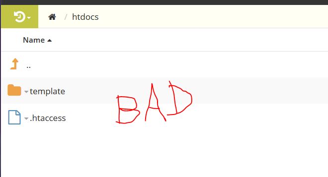

hello @Admin your previous suggestion simply eradicated the issue i was facing and i successfully uploaded all the files of my website through filezilla to the htdocs folder. but still now my website has the same coming soon page offered by infinityfree.net can you please help about this?
Please make sure the file you want as a home page is called index.html or index.php. If you call the file something else (e.g. home.html or welcome.php), then it won’t be served as the home page. Also, note that our servers, like almost all web hosting servers, are case sensitive (so INDEX.html and index.html are different pages).
when you did the unzip
then often the first folder has the same name as the zip file (or more)
It is up to you to enter so deeply (into the folders structure) until you reach the file called index.html (if that is a html template)
and then upload all files and subfolders from that location in htdocs
