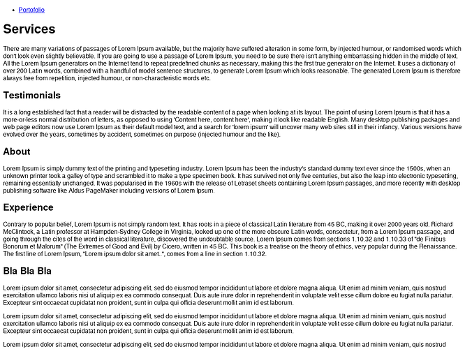

This is the simple example from your problem:
Try to open it & click Portofolio menu. Then click the link from Portofolio page.
Will it works on you?
