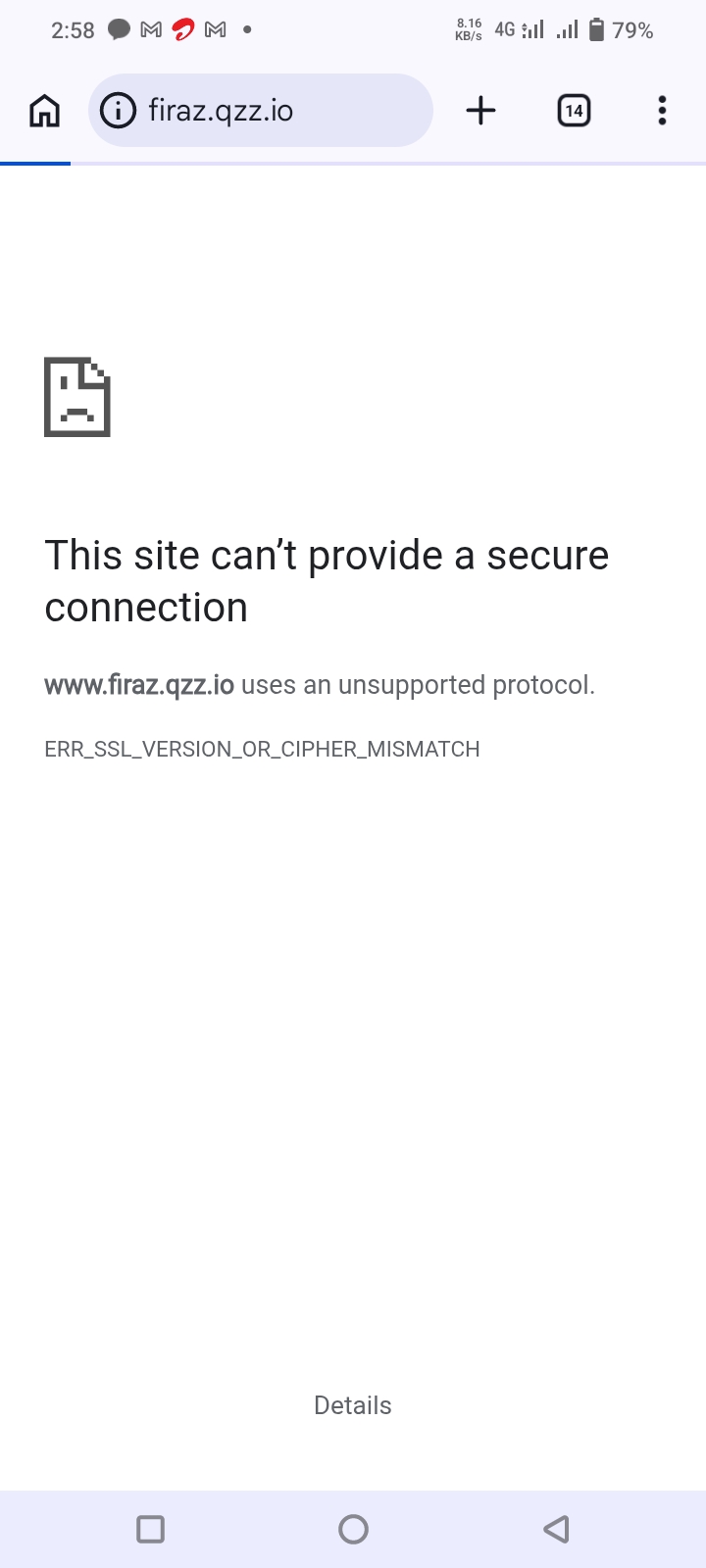

Getting Domain Uses Unsupported Protocol & error
https://www.firaz.qzz.io Or https://firaz.qzz.io
www.firaz.qzz.io uses an unsupported protocol.
ERR_SSL_VERSION_OR_CIPHER_MISMATCH

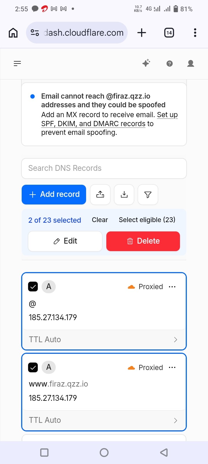

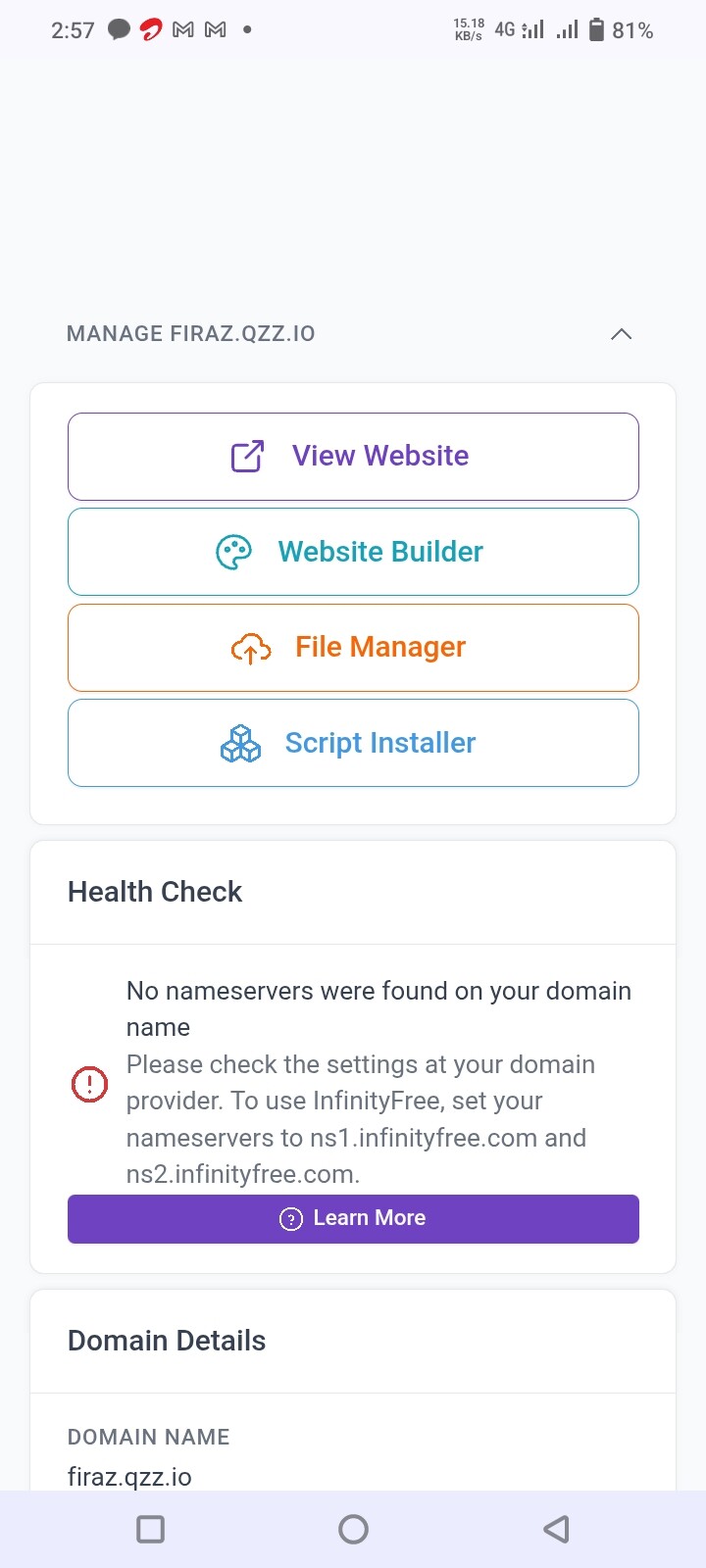

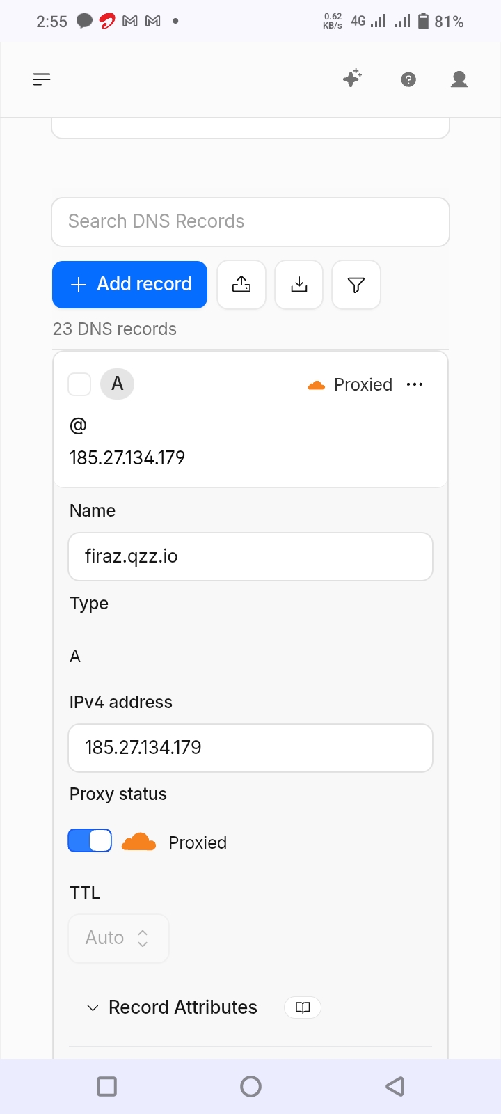

Recently, i have registered 2 domain from digital plat, then added to infinityfree, then connected to cloudfare. However, 1 domain is working properly, but this domain “firaz.qzz.io” Is giving error,
Username: if0_39515950
Website IP: 185.27.134.179
In Cloudfare, it is showing that it id now active, but error that i am getting is confusion me problem is from which side. Is there is problem with website ip, as another domain, i have added to a other hosting account, it was having different IP.

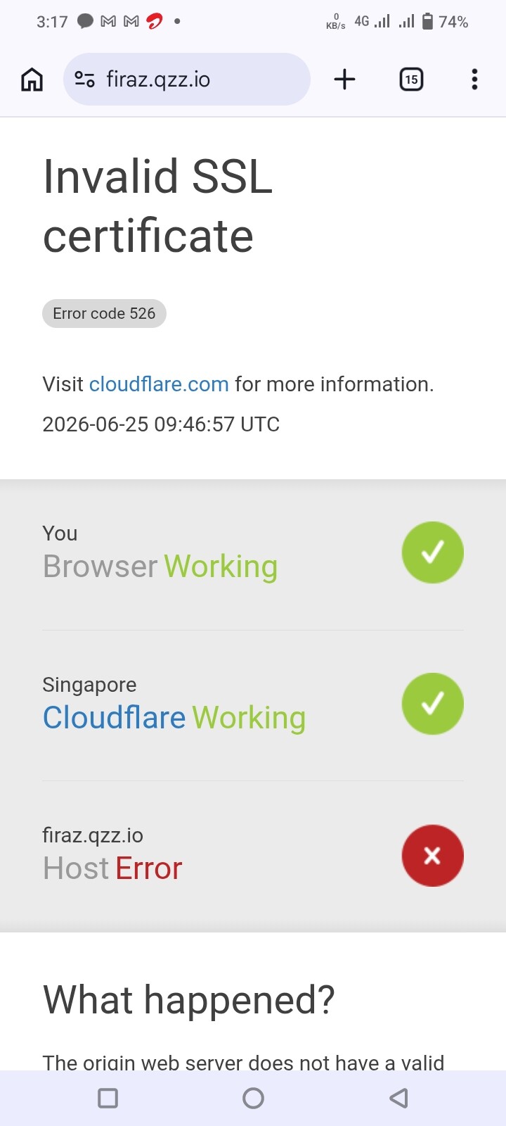

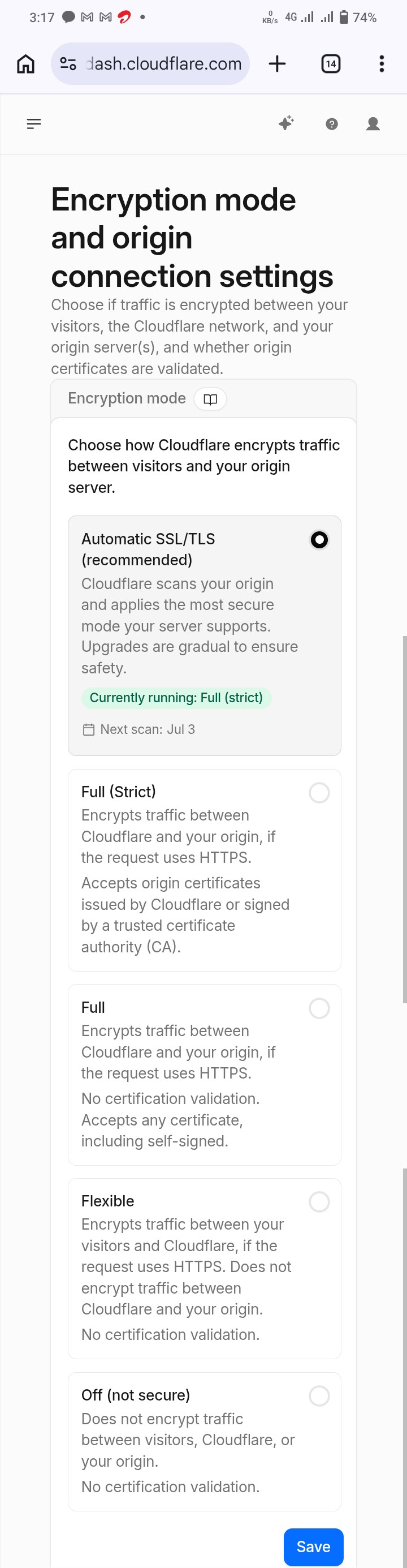

I’ve never got “full (strict)” mode to work, try changing it to just “full” instead. That works for me
But in another domain, it automatic, and there is no problem in that, but in this, i am having
On the one thats working, has Automatic Selected Full (strict) though?
They very nature of it being automatic means it can select different options for different domains
In full, it is working, but why it is not working in full(strict) & automatic, although my other domain work in automatic
Both domains work fine for me.
Because i have changed SSL mode to Full
The ERR_SSL_VERSION_OR_CIPHER_MISMATCH error indicates a problem with the SSL connection between your browser and whatever it connects to (be that our server or Cloudflare). If it was connected to Cloudflare, that probably meant that Cloudflare hadn’t setup the SSL certificate for your domain yet. Cloudflare can take up to 24 hours to activate the SSL certificate for your website.
Regardless, that issue is between you and Cloudflare. When using Cloudflare’s proxy, the SSL certificate presented to browsers is managed by Cloudflare, we have no control over that.
