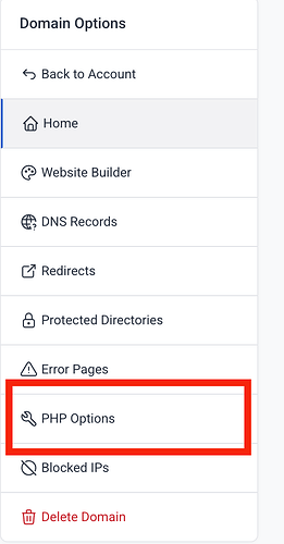

In order to view PHP/MySQL errors:
Go to PHP Options for your domain

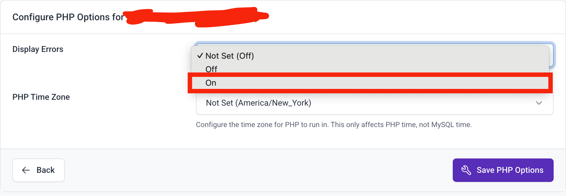

Set PHP’s “Display Errors” option to “On”
After this, please share the error you see printed on-screen when you perform your actions, and we can try to help you out.
