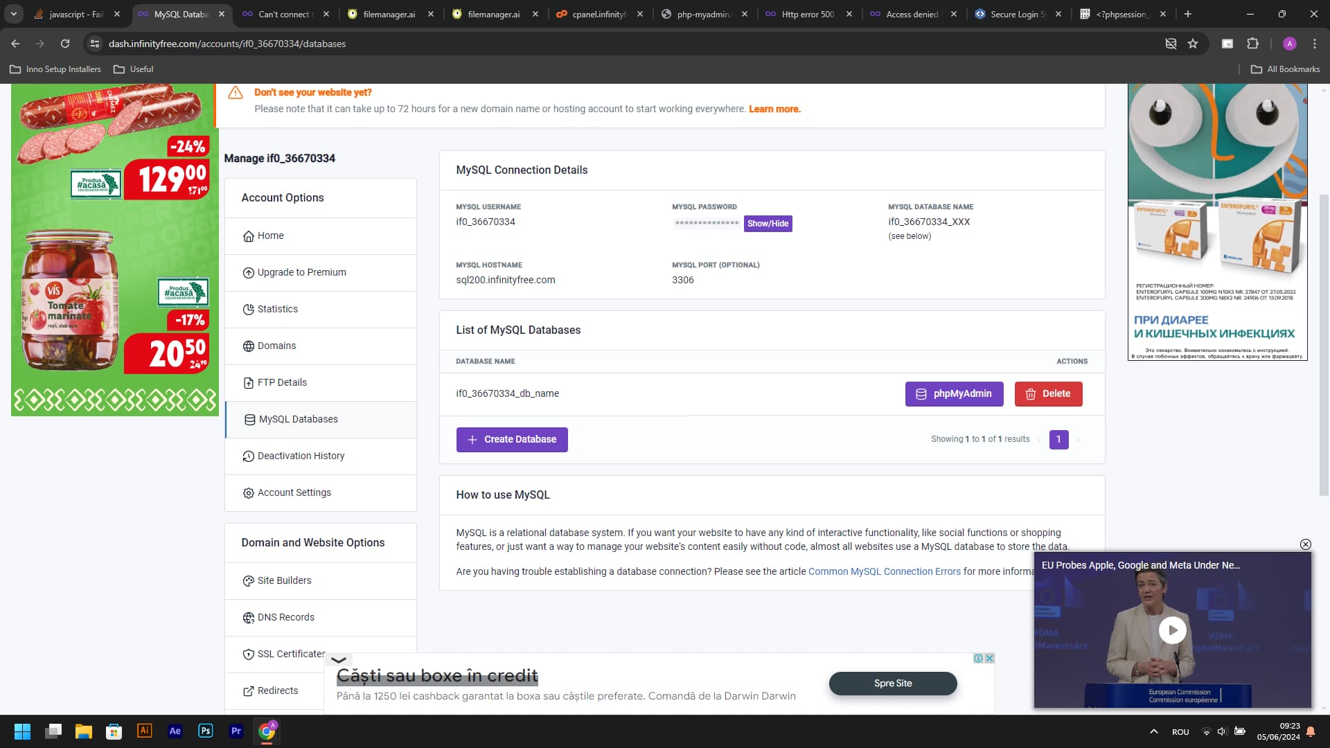

no this is the db name
there is a screenshot confirming that
I tried to delete the database and to create it again with the name if0_36670334_phplogin but it still didnt work
