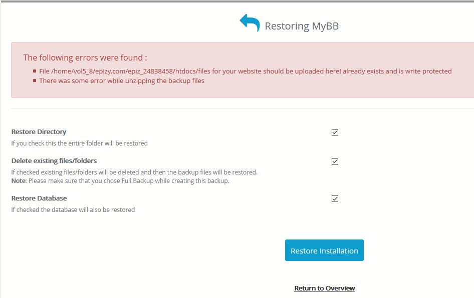

### Error Message
 ![image](https://forum-cdn.infinityfree.net/original/3X/0/6/0688b28d22a724b93669b681e27932ebd54bbde1.png)
### Other Information
There is an update from MyBB that worked fine in my forum on localhost, it didn’t work on the website forum. The update is from ver. 1.8.24 to 1.8.25, I have done these updates two times before with no problems (1.8.22 to .23, then to .24) for whatever reason this one to 1.8.25 failed. I have an error message from the attempted installation, but I’d like to restore the forum site first and retry the update. This is a very small forum that’s not very active with only a dozen members, but I’d like to get it back up and functioning.
Thanks for your responses 🙂
Steve

Hmm, can you remove that file and try again? (the place holder ‘your files should be uploaded here’)
And regarding the update, i would appreciate if you show the screenshots of that error.

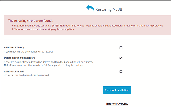

I tried to find that file to see if I could change the protection, or do something with it using file manager, I couldn’t find it.
There are two files under htdocs/home/vol5\_8/epizy.com/epiz\_24838458/softaculous\_backups/tmp/mybb.35\_56495.2021-01-31\_10-11-46 and softsql.sql.
 ![image](https://forum-cdn.infinityfree.net/original/2X/b/b78a6186f2bbc18b44533cb32a50ad2fcc45802a.png)
Can you help me find the right file file?
Next post will be the update failed error message.
