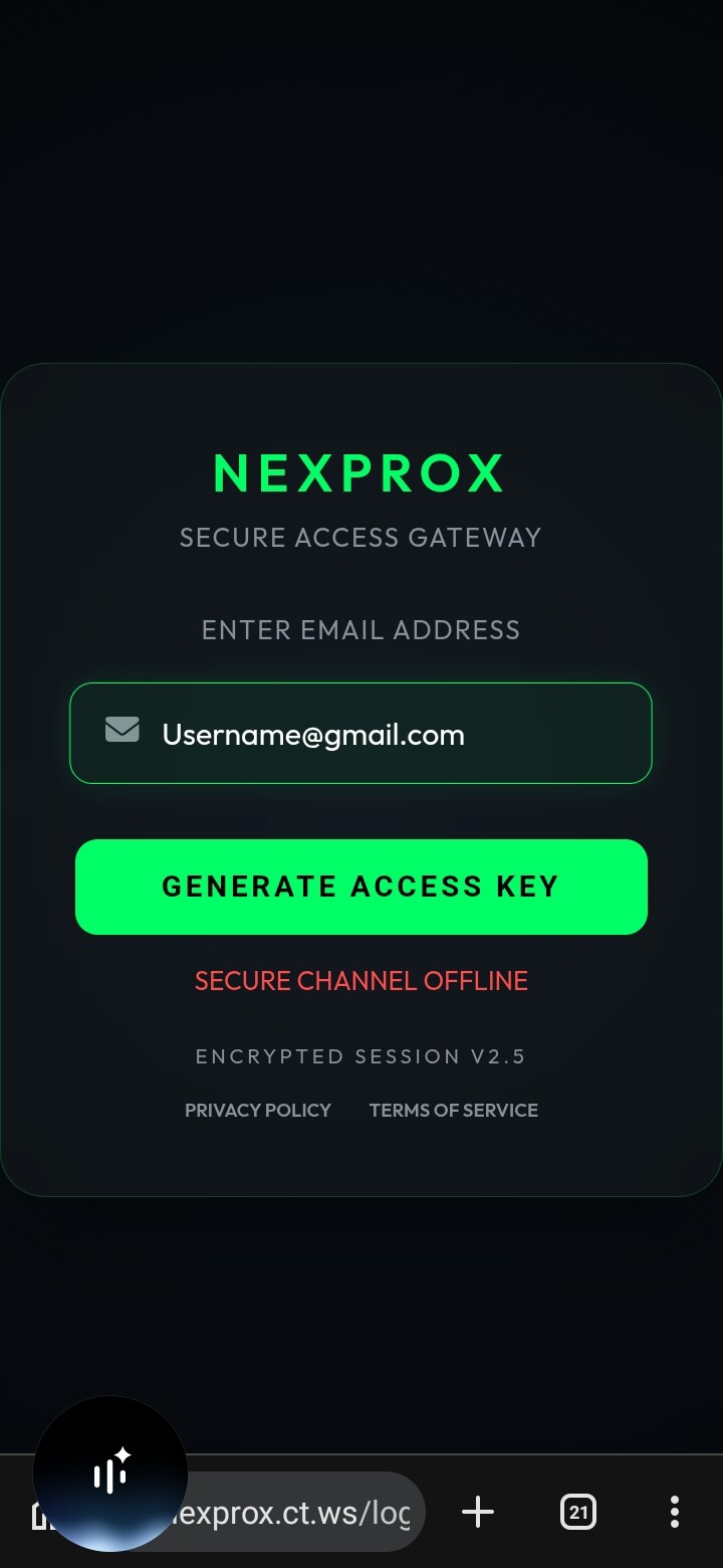

Hello I’m trying to access the backend of my website nexprox.ct.ws but I’m consistently seeing a security channel offline error I’ve checked my code and forced https and they’re seems to be an issue with the secure connection could you please check if there’s a configuration error on the server side

No when I enter my website to login it will not work Saying backend offline so it seems like the backend server is not working

Actually can you share a screenshot of the error (including the URL) so we can help further
when i try to login http://nexprox.ct.ws i get the secure channel offline error from my code backend which shows on the nexprox screen and I have checked my code and forced https redirect on the platform so it seems like a server problem and I could also give link to my github repository so you can review my code for more details GitHub - ZEDON-ARCH/Nexprox: An advanced proxy with integrated tunnel system and powerful server · GitHub

Node.JS is not supported on free hosting. Not sure what you’re trying to do.
I’ve not looked at your code yet. But this isn’t going to be a “server” problem.
Is either a code problem, or you’re trying to do something unsupported.
If you’re using node.js like Greenreader9 said then that’s not supported. The only server side language that is supported is PHP. Client side language like JavaScript are supported
Okay I have completely changed the server.js file to a PHP database and is currently working right, so I want to thank you all from your assistance in helping me achieve it you can check out the website using this website link https://nexprox.ct.ws but I’m trying to look for how I can place the email or TLS/SSL for emailing of credentials
The php mail() function is disabled. So you’ll need to use SMTP to send email.
