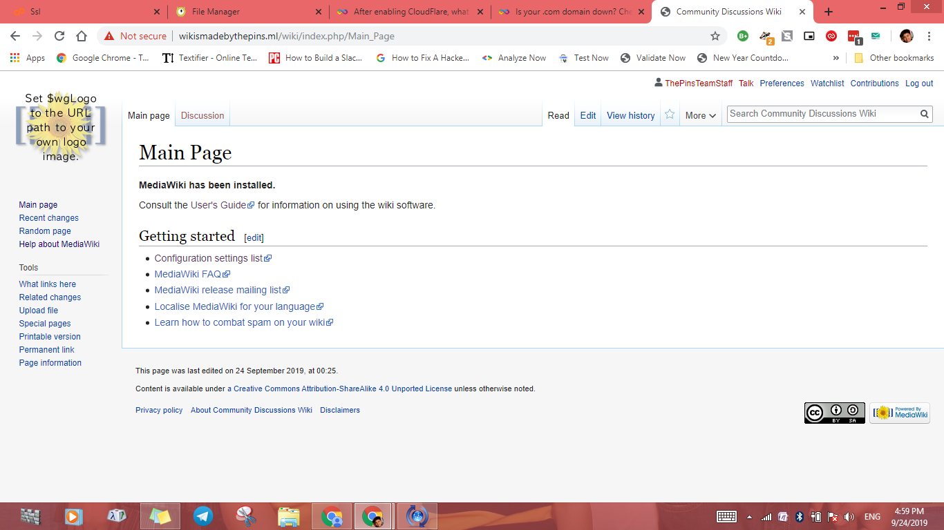

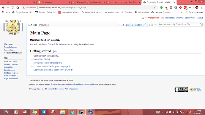

I also have that issue on https://wikismadebythepins.ml/wiki/index.php/Main_Page like this:
(The Not Secure is shown in the address bar, not the green :lock: one.)
It’s not showing SSL for me either. Are you using CloudFlare via cPanel or manual?
I just switched to Cloudflare back using DNS.
By using CloudFlare nameservers?
Anyhow, if you’ve only recently enabled CloudFlare/SSL, you should try waiting a few hours as it can sometimes take awhile to activate.
My favourite tool to check if SSL is working on my website is whynopadlock.com – and also makes sure that the SSL error isn’t happening because your DNS/browser cache,
According to whynopadlock.com, your SSL certificate is not active yet.

Updated as of 5:47PM (PH Standard Time): I’m still having problems in encrypting things. Did I need to create an certificate of my own?
It looks like your website just got SSL activated!
Please try flush your DNS cache and clear your browser cache to ensure you get SSL picked up by your browser.
One issue picked up is your website has mixed content, which will display an insecure padlock in most browsers.
The Mixed content tests failed. Please be sure that you can connect to your site over SSL and try again.
Error Returned: net::ERR_TOO_MANY_REDIRECTS at https://wikismadebythepins.ml/wiki/index.php/Main_Page

May I see the results link so I can fix the issue?
Click here for the result link and scroll down to see the error.
Though this won’t automatically update, so I suggest going to whynopadlock.com and pasting in your page link to get a fresh check.
The mixed content error happens mostly because some content on your website is still HTTP.
EDIT: Uh oh, it seems your website is doing infinite redirects too. I can’t tell you how to fix this, maybe it’s something to do with your wiki software or some configuration.

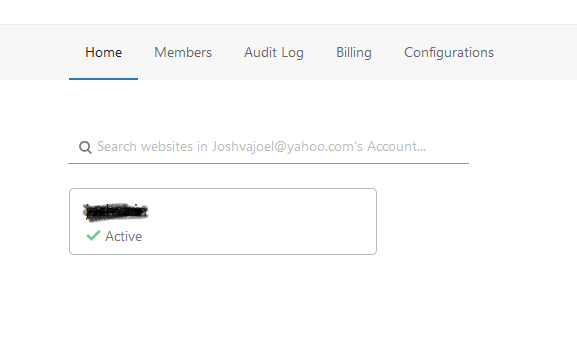

I altered the Cloudflare option in cpanel. I have disabled it , but still in cloudflare account my website is showing active. what to do ?image
Have to wait 24hrs atleast.
